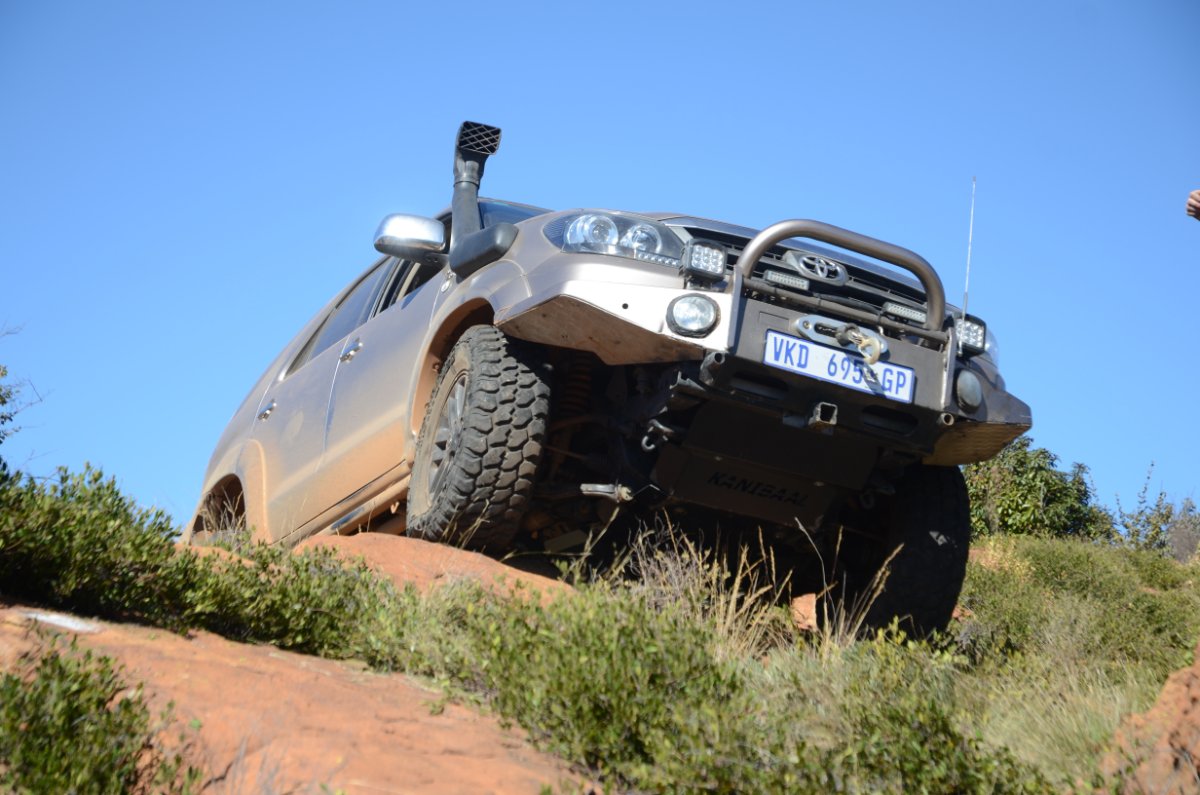

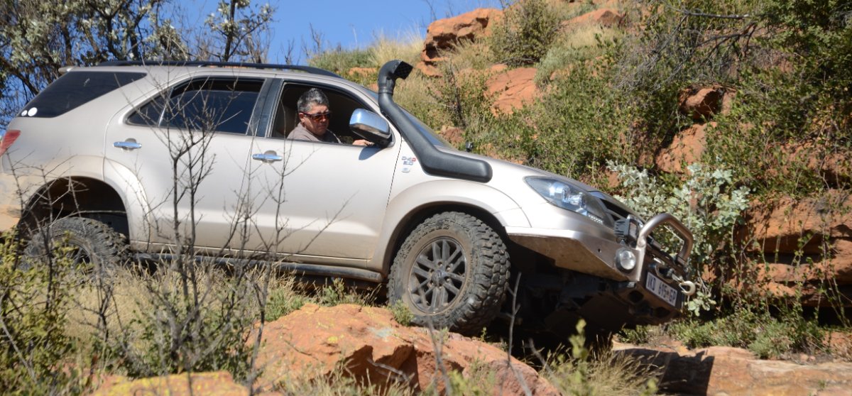

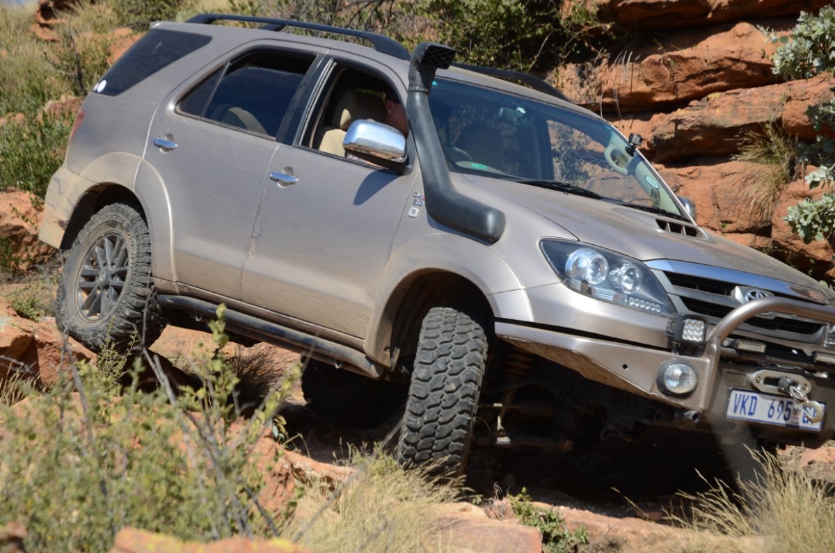

Kurt, I said it before, nothing would have withstood constant digging and spinning on that flat rock, those splinters were terrible. These picture will give an idea of the terrain we travelled the past two weekends, and both makes were brilliant.
Keep in mind my Achilles tyres were fitted before we did the 10 passes trip.
So the passes trip, river trip, Mogatle river , the Gorge, and the Road to Hell, its done over 40 000km's already, and good for another 40 000km.
So from the pictures its clear, I am not shy of playing in the rocky sections, unlike all gravel runners, testing the donkey cart routes. Lol,
