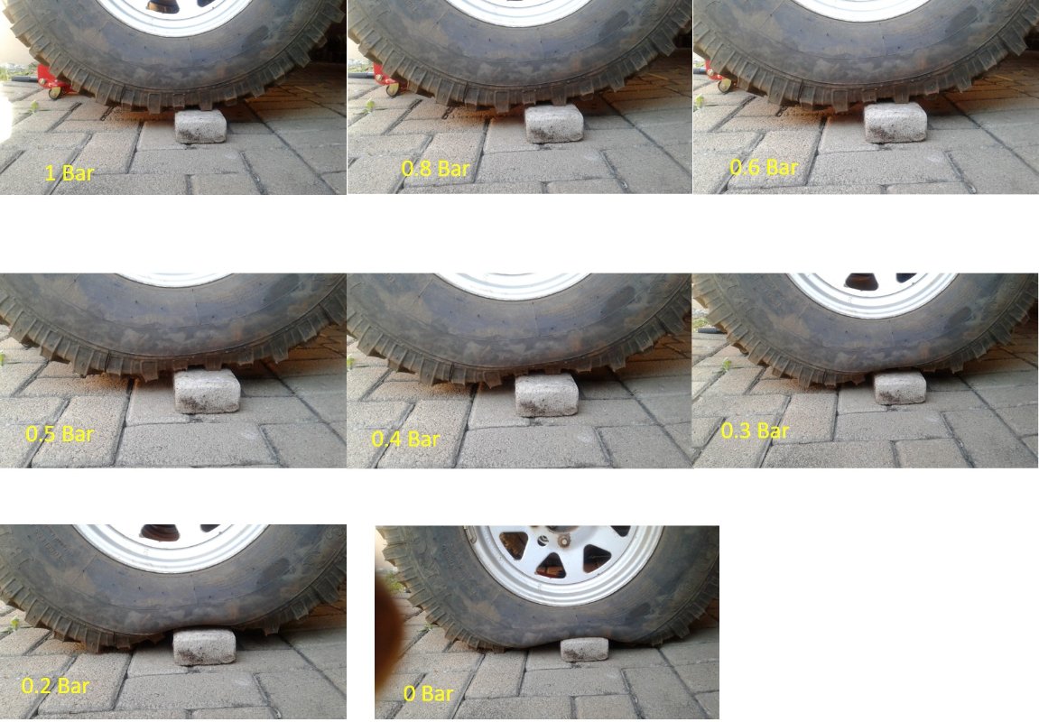

I use the "brick test" to get an idea of tyre pressures (and tyre deformation) for a vehicle / tyre combinations that I don't know.
The pic below is from the test when I fitted the 31X10.5 remoulds to the SJ.
Vehicle is lightly loaded for a day outing
