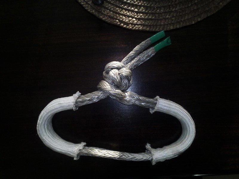

this is my quick to make soft shackle.2 minutes.
material: 1.7m of 10mm super 12 uhmwpe. edited:must be 1.7m not 1.9m
