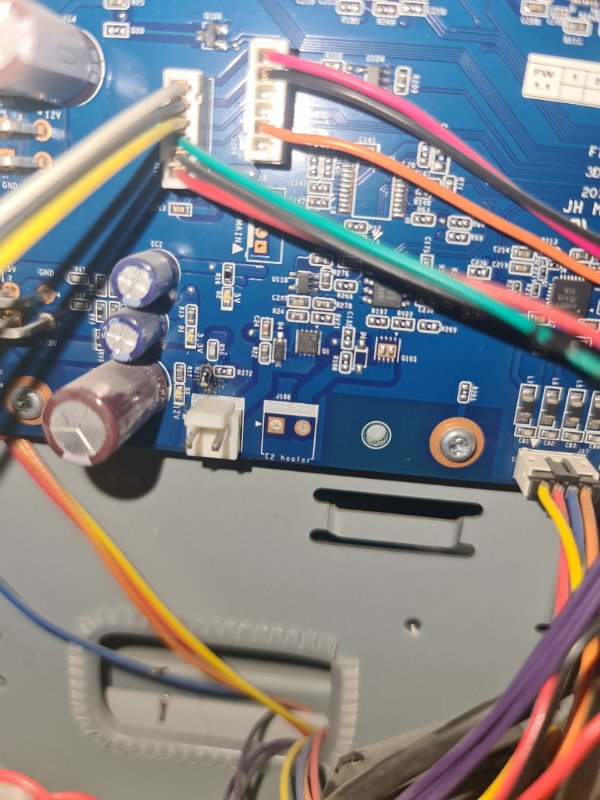

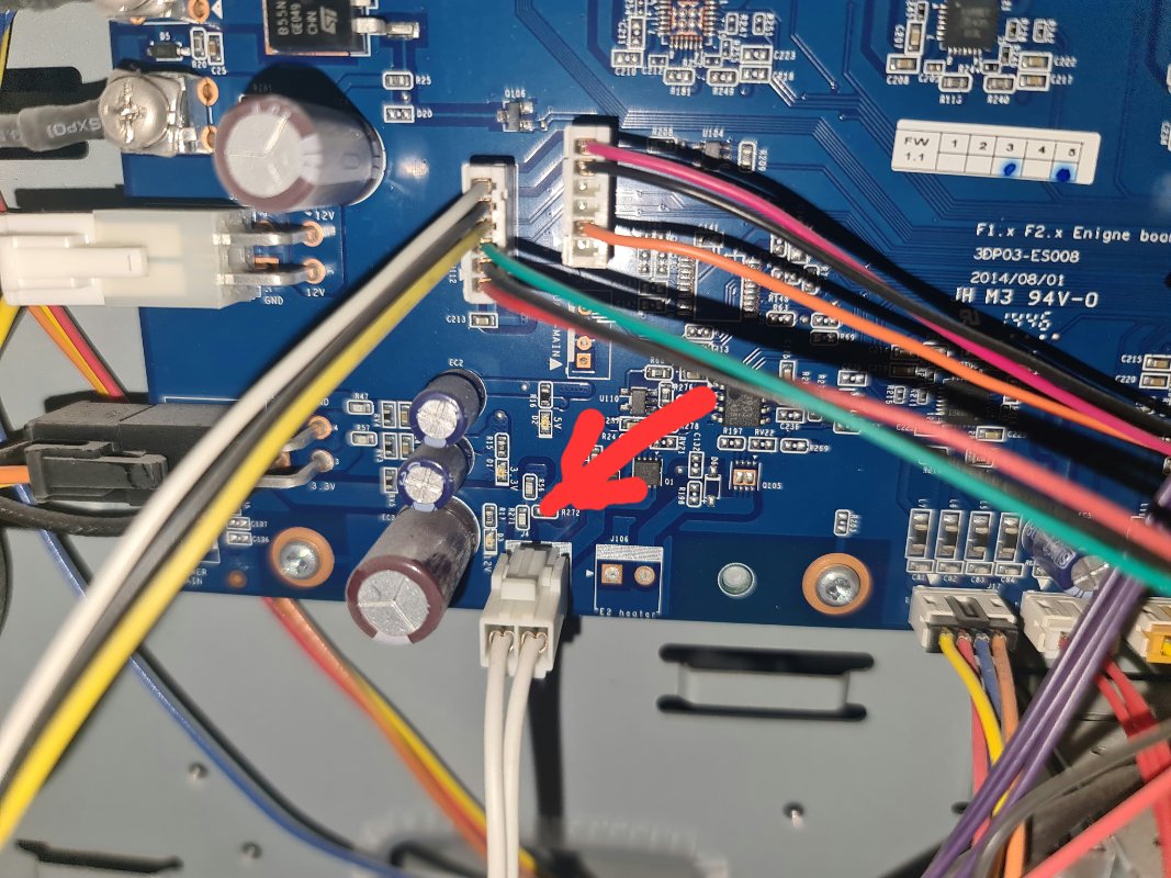

Fast forward a week or two later, a friend of mine mentioned on a WhatsApp group he was throwing a printer out if anybody was interested. So I said yay - I was. I collected the broken item for the cost of a case of beer thinking it was completely buggered but that I'd at least be able to use the frame and the other working bits (motors, etc) and build a newer and more current printer between it and my old one. A bit of investigation into the thing and I realised the big issue was the fact that no power was getting to the hot-end. A bit of googling, and it turns out that the motherboard uses a zero-ohm resistor (highlighted red) to provide power to the extruder. And there was no connectivity at all between the one side of the resistor to the other. In short: at some point the extruder had shorted out and burnt the resistor...

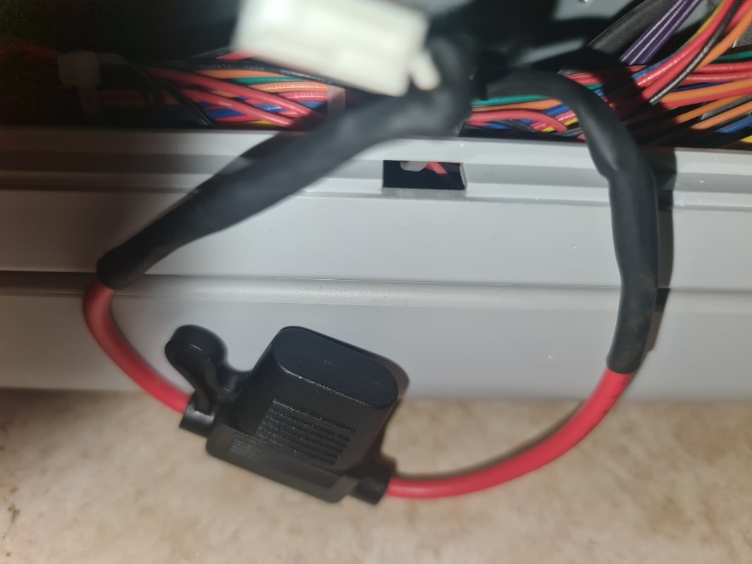

And so I bridged out the resistor with solder, opting instead to install a 5V fuse inline with the extruder cabling to protect the power supply in the case of future shorts.
And it works...
