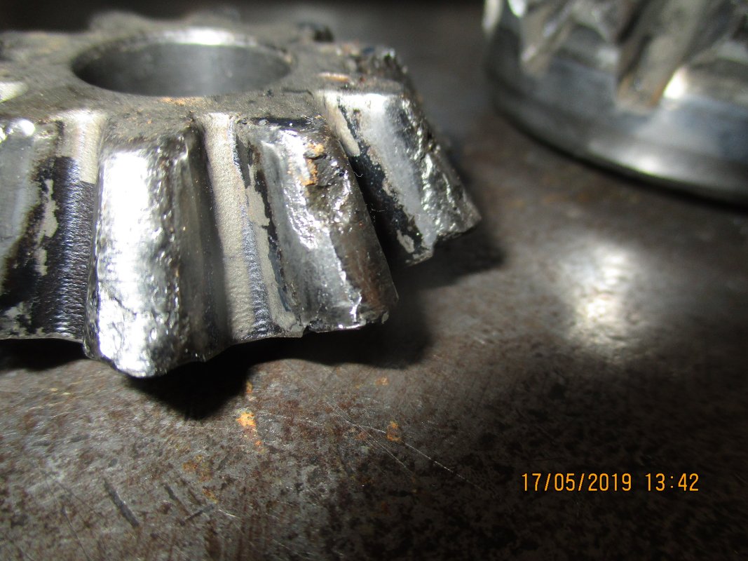

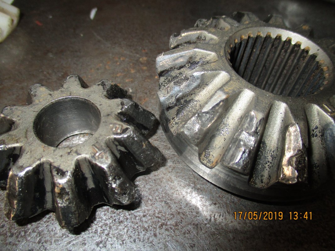

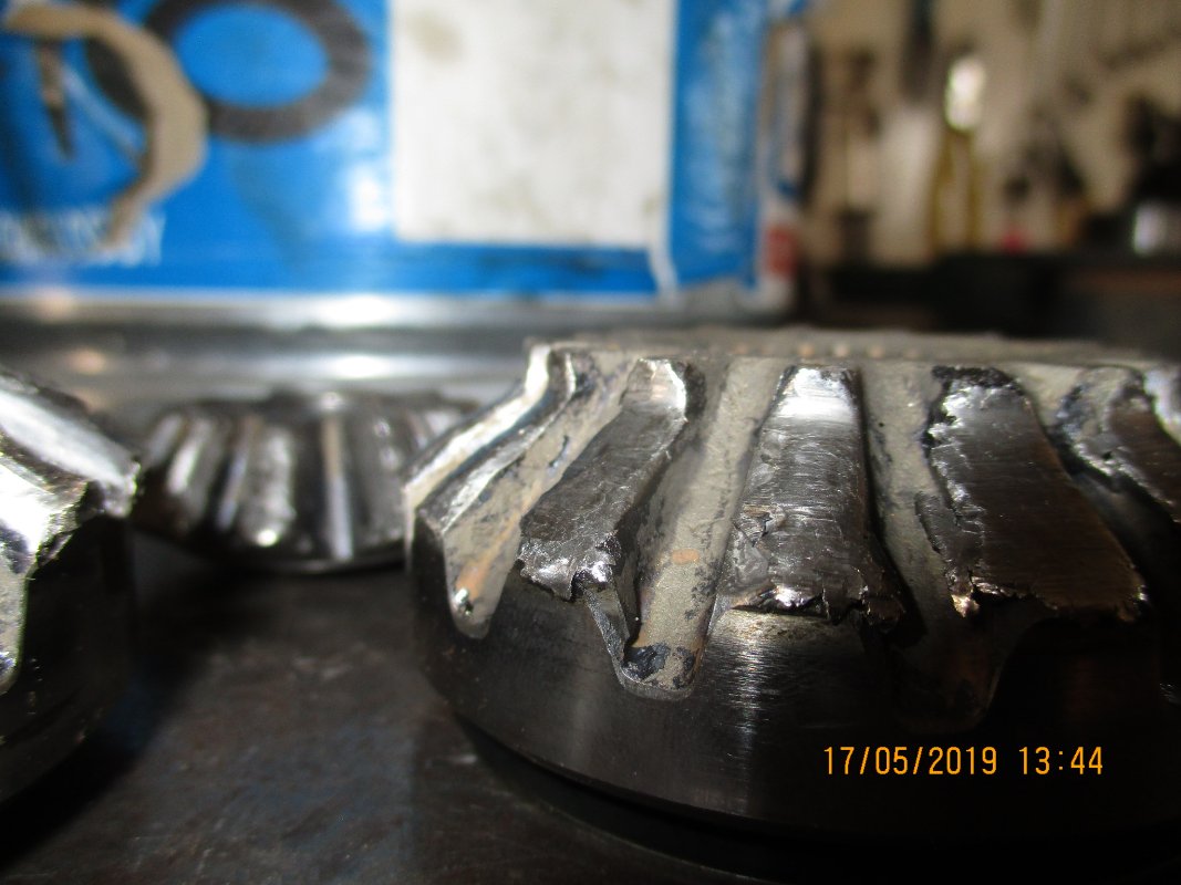

We needed to fit MOST of my original parts to the PartHunt Diff, as my original parts (except the diff internals) were in far better condition.
We then analyzed the damaged parts... see pics in next post...
A tale about a 2004 Mitsubishi Colt 2800D workhorse bakkie:
2019:
The pictures clearly show (& Paul#25, Apoc, Ginger & Grips confirm this) that the diff was very poorly assembled - this means that Gearmax is responsible for the failure, yet they wanted to rip me R8500 to fix their stuff up... :oops:

Anyway, that's where we are now - hopefully the Colt will be back on Wednesday (2 weeks off the road).
I'll keep you posted.
Apocalypse wrote:
Sat May 18, 2019 9:17 pm
Oh. And I’ve just realized .
Those rpm figures I gave you earlier would be for 4th, 1:1 ratio and not 5th which is usually an overdrive!
I figured as much as you didn't have the 5th gear ratio.
But your advice was invaluable & helped me make the decision...
