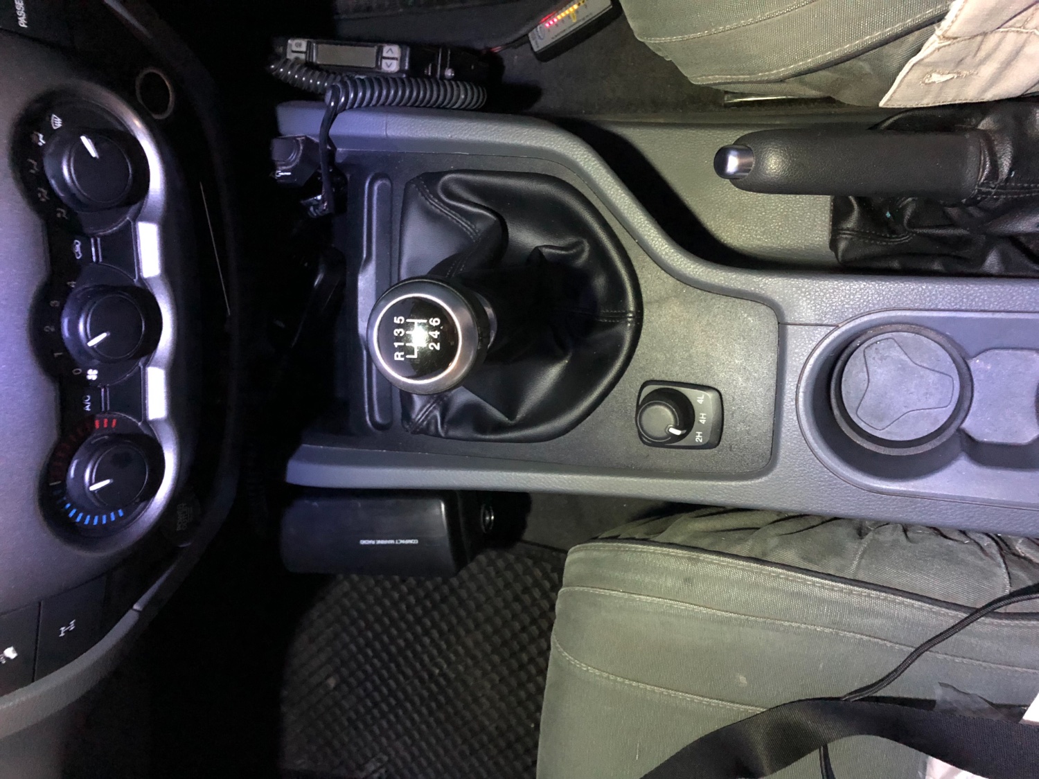

29Mhz on left and and Vhf on right
Image Image
Pictures showing Kenwood radio Mike bracket
and its positioning in Defender...
Radio itself can be seen to left and lower
than gear-change lever boot ...
sits vertically on side of the transmission tunnel ,
on passenger side.
