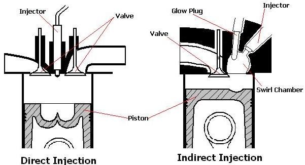

Now for the clever guys. Do you run the same EGT and AFR on an indirect pre-chamber engine than on a Direct Injection engine?

- grips
- Location: kathu
- Has thanked: 39 times
- Been thanked: 134 times
- Posts: 1169
Nope. Indirect injection have pre cambers in the head. Very common on the older normal aspirated diesel engines. Direct Injection have the combustion chambers in the pistons.
