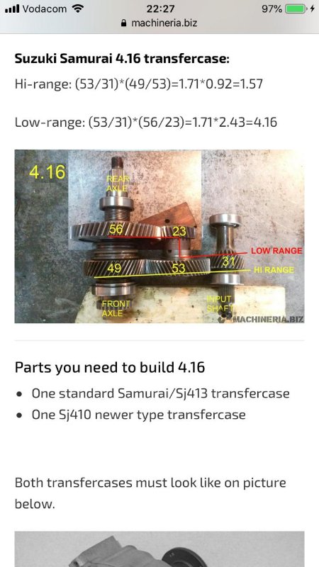

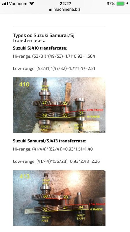

Wooky, there is a mod you can do to your TC. You need to get a SJ413 TC, and build portion of it over into your casing. Not sure exactly how it works, but the guys on our SJ whatsapp group was chatting about it. I think there was some pics explaining it. I'll go have a look, and port it for you.
Its called a rock lobster. That is currently what I have but from an engineering point of view it is a real bastardised job.
You end up with a cut and welded middle gear in case.
I had ordered and paid for a complete new gear set to be fitted by a reputable seller / 4x4 fitment place. What I got back was an horrific abortion.
Stuck with it for now but looking at getting a new gear set when the funds allow.

Is this what you are talking about?

yep that's it....
It should be 4.16:1 but when I counted on mine it is 4.25 for some reason.
I forgot to count the teeth on the actual gears when I had the case out recently to sort it out so not 100% sure what gears have been used.

Post by david bfreesani »
I did not realize that stuff had to be cut to fit. The description given on our group makes it sound like you just swop some of the gears over, and it's job done.
