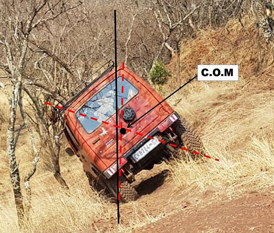

This is my simple method.
Not 100% correct but gives a reasonable indication
When the COM dot crosses the vertical black line you are going over

How do you calculate COM?

It's not really calculated and hence not 100% accurate.
Basically the two red dashed lines drawn corner to corner in my photo.
As cars are somewhat "box" like laterally, where the two lines cross is approximately where the COM will be.

That was quite a moment. That's as close to tipping over as I've come since I tipped that very same vehicle on it's side about 25 years ago.
