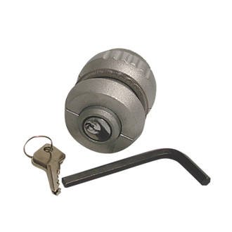

... and now there are trailer cuffs... I've just bought one and will describe it in an accompanying note in this thread.
https://ibb.co/tqpk74s
So what thoughts/thinking do you guys have on these hitching / de-hitching aspects and whats the way to go ... what other considerations are there ???

Can it be used for safety though, as in when parked, can the thingy prevent theft at all?
I have bought the "Trailer Cop" it's about R165 from Midas or Outdoor Warehouse, it clamps inside the coupler.
