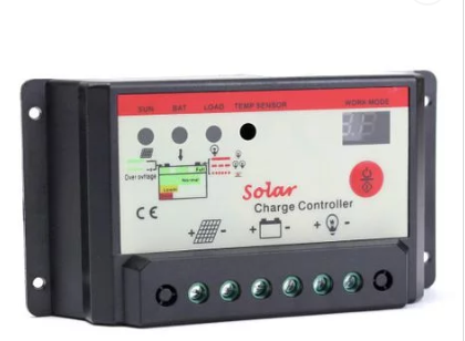

I found this on Takealot:
30A Digital Solar Regulator 12V/24V Rating for R424, seems like a pretty decent price.
https://www.takealot.com/30a-digital-so ... l+Campaign
mplester
Location: Pennington KZN
Been thanked: 5 times
Posts: 15
Joined: Sun Dec 23, 2018 8:00 am
Post by mplester »
Just remember that this is a pwm regulator and not as efficient as an mppt

PWM regulators are just fine for camping set-ups.
