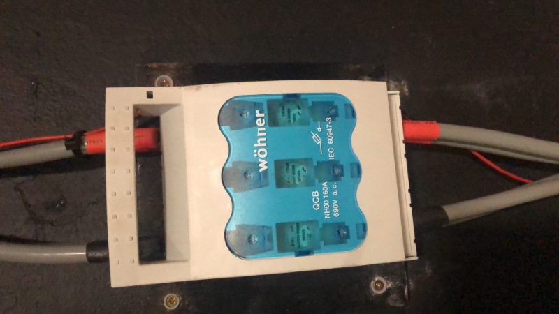

There are fuses and fuse holders available in that region - this is the one doing duty for the standby invertor at my house... 150Amp fuses x 3 (only using 2 )
You can get bigger ones - that one is about 3k with fuses
