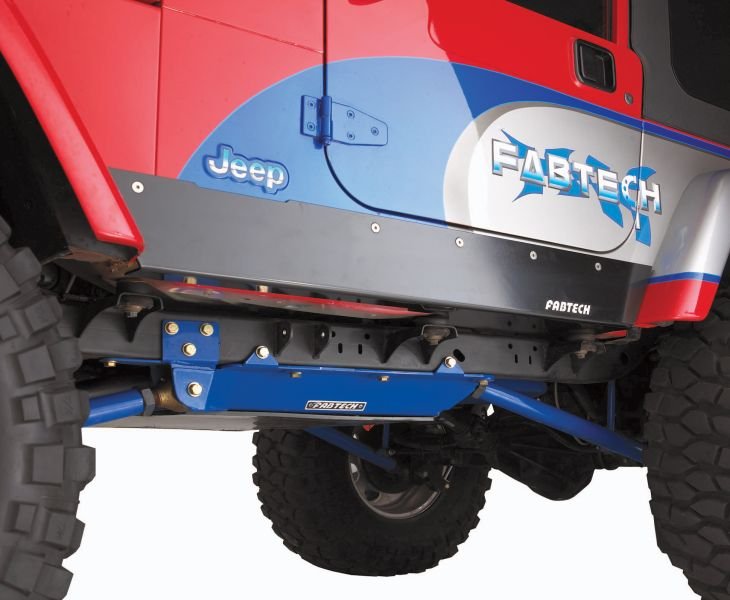

I was thinking along these lines. See Photo.

Chris Stoffel wrote:I was thinking along these lines. See Photo.
These aren’t rock sliders, they are body protectors, very different to the thread title.
But Kurt, ain't it the same thing? Same purpose?
Not really. The slider (if designed properly) can allow you to bash your way over rocks and slide over if need be without causing any damage to your vehicle, body protection will dent and damage what’s underneath if the same forces were applied. There’s a big difference.
First photo.....are you just joking?
KurtG wrote: These aren’t rock sliders, they are body protectors, very different to the thread title.
Shhhh 🤣
Won't 8mm steel plate protect the body? Those in my pics look like 3mm or so.
