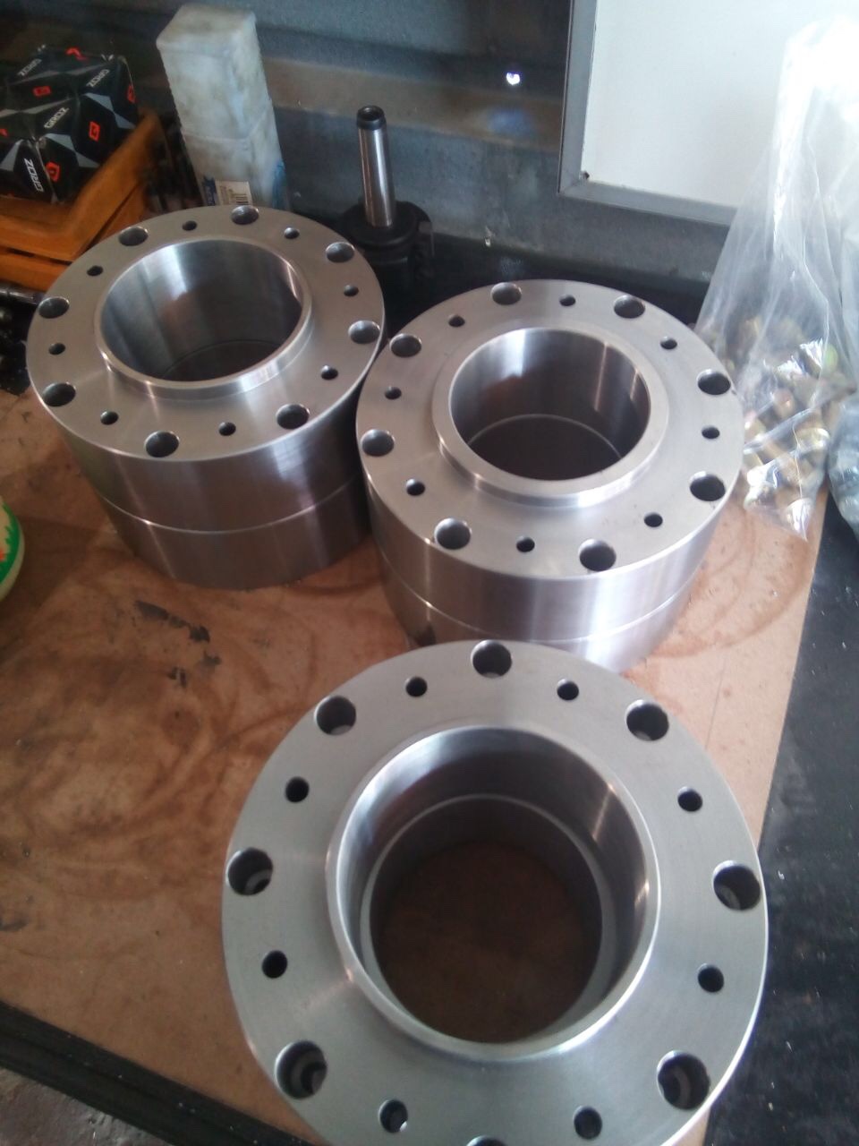

Netjies !!! Maak jy dit self?

My broer in Boksburg maak , as julle soek .Maar hy soek pcd ens.
I have spacers on both Cruisers. Have made a set for the Yank Ranger but have not fit them yet, want to do a rear drum to disc brake conversion first.
I’ve always been keen to add 10mm spacers to my Pajero, the wheels seem to be that little bit too “inside” the arches. Most spacers you find are 25-30mm which I don’t want.
My question (and this has always worried me) is where can I buy longer wheel nuts and will the extra 10mm length makes them too weak for the application creating a potential problem in the long run?
I might be interested Johannes ...
I dont really want to use as a spacer as such
but for versatility
eg to use 6-stud rim on a 5 stud hub
or eg to use landy rim on toyota or vice versa
