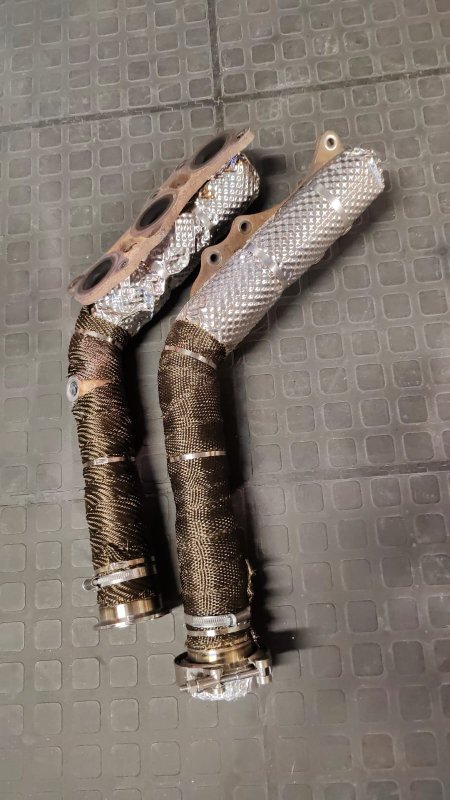

Here a picture can be seen of wrapping the exhaust manifolds with some special magic, keeping a lot of the heat away from the engine bay. Also they decided to put some special imported heat reflectors on, which really seem to do the job extremely well!

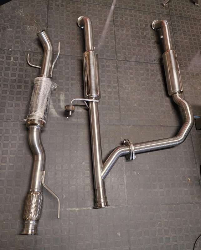

Here we can see the finished product before installation. This would have two resonators after each exhaust manifold, and one larger one where the silencer was. The beauty of this system is that the whole exhaust system is now about two inches higher than it was, but with a larger diameter pipe (2 - 2 ½ inches pipe). So no more scraping the exhaust and one less worry.

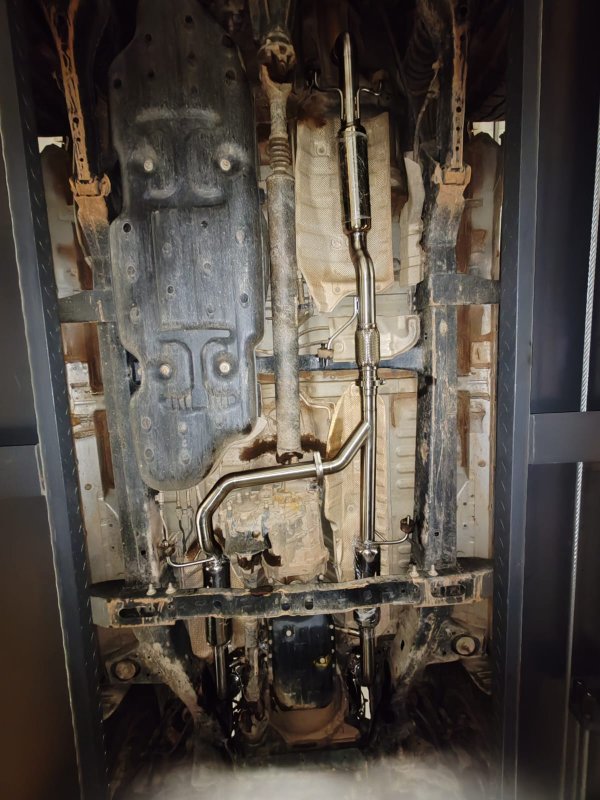

Now installed in the vehicle, looking absolutely great and all out the way!

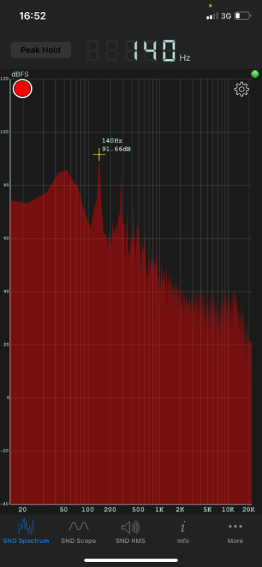

This was also verified by a free app when driving and hearing the resonance(Drone) frequency.

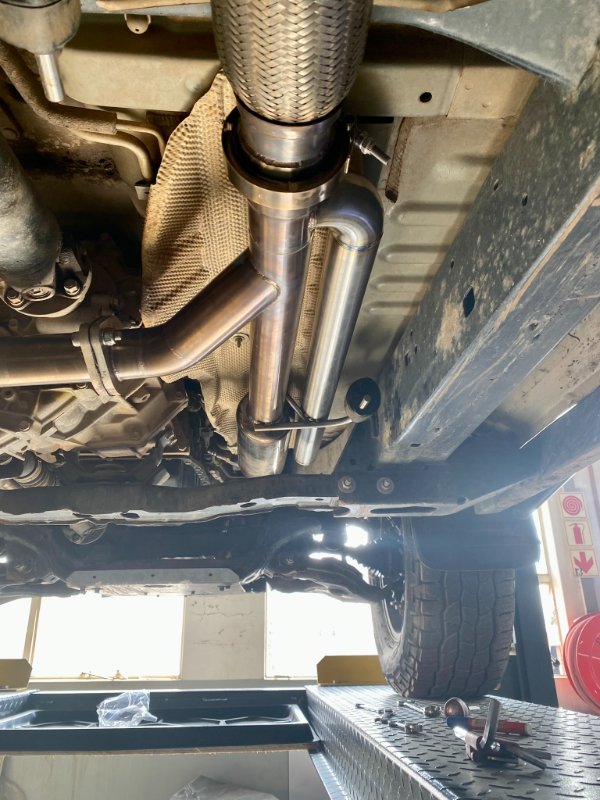

Next up make a J-Pipe. Fit it and test. Again took it to Marco at Tignique. They indulged me in my playing around and installed the pipe for me. Here are some pictures.
And would you believe it. It works! Drone is 90% gone, think my temperature measurement was a bit out, but now the vehicle sounds exactly as I wanted it, without any drone at a specific range and much more linear.
