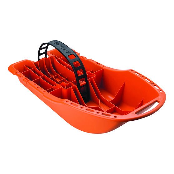

Once you are bogged don't try and free it "one more time" by going backwards and forwards.
Unhook le-trailer and get the vehicle out. Seen my fare where they've just totally buried the tow vehicle.
Get something under the jockey wheel and recover trailer like normal recovery. There's some nice specific items for this, but I've used a shovel for this in the past.
