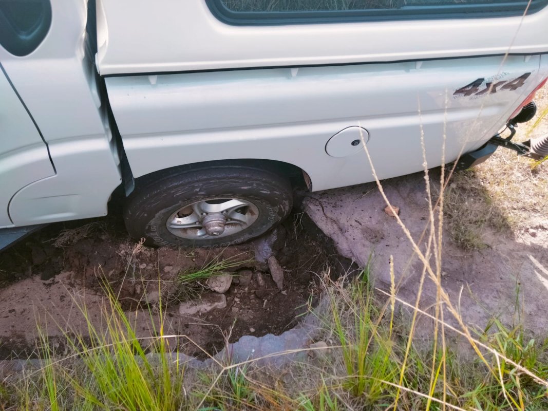

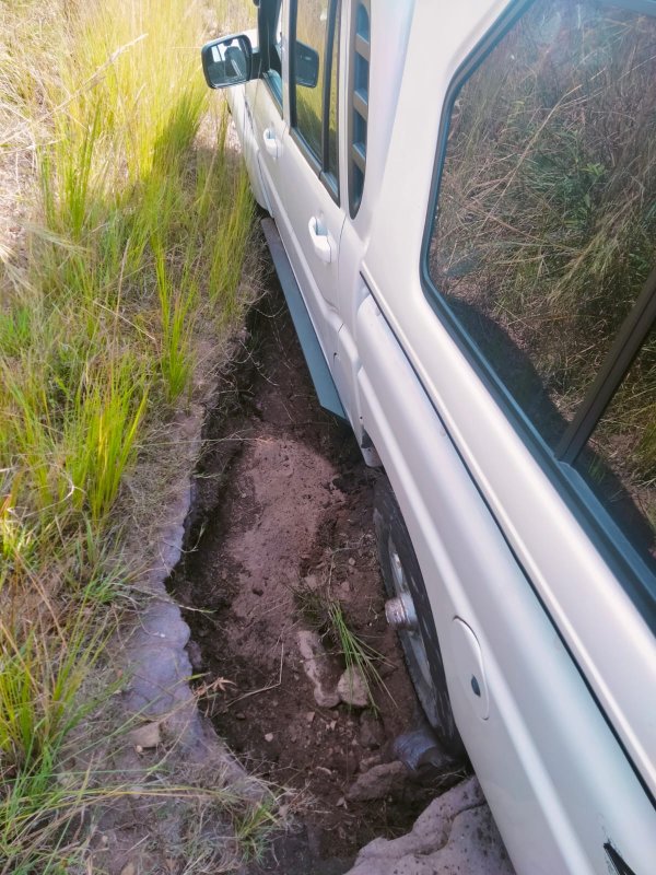

few times it got me surprised over rocks where vehicle needs to crawl,stop,crawl,stop.
every time i stop in cross axle situation locker disengage it self and refuse to lock again
unless i reverse half of meter and try to pull away again.
it becomes interesting if there is no space to reverse or can not reverse.
in videos named fail to engage bakkie is siting on rear diff while left side is inside sink hole(photos) and i had to winch my self out
https://www.youtube.com/watch?v=Dj8hzu70dgw
