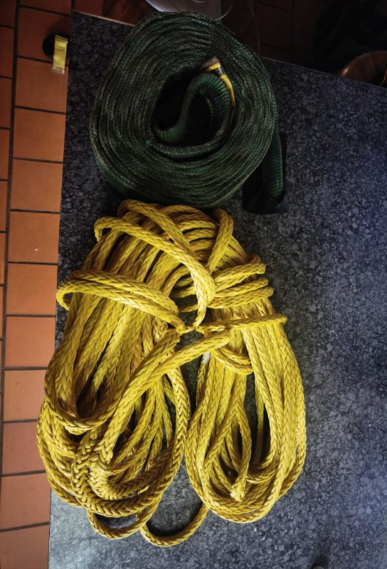

To me this is a new direction I predict the whole 4x4 world will eventually adopt. Using dyneema rope instead of metal.
[Note: Kevin is referring to a Winch Rope/Cable]
Safer, lighter, smaller, cheaper (in the long run, not requiring extra safety measures), repairable, user friendly, snatch block friendly for redirects.
I have learnt a lot recently and would like to share my learnings and maybe argue if need be.
The usual 5m pull strap and steel bow shackle is now old tech, and soft shackle on a dyneema rope is the replacement.
There is no metal in the setup so safety lanyards and blankets arent necessary. With a safety factor of 5:1, a 2 T WLL rope will be more than enough for any pull.
This is a 5m Pull strap weighing 1.7kg next to a 30m dyneema rope at 1.5kg. Similar Load Limits Then a 167g soft shackle next to a 576g bow shackle Basic recovery kit with 1x rope and 2x shackles would be about ~630g and can be stuffed into small areas

I know some people use this setup already, but for those you dont, would you convert?
