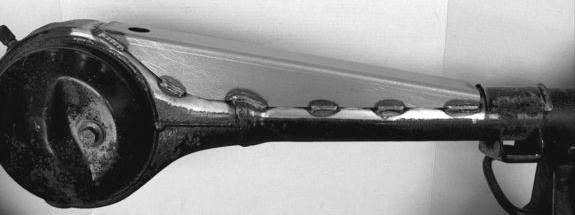

I have been looking around for the past month and have come up short on anyone who would be able to do it.
Gearmax didn't even respond to my enquiry.
A new housing would be option 1
Option 2 is to try and beef up the housing I have
Option 3 will be an axle swap

Wooky. the best way to mod the std axle imo will be to grind the brackets off completely and install a wider and deeper sitting perch like the ones from Rocky offroad.
Going full coil over has plenty of issues on its own, and like you said, everything is basically new. why change everything for one failing part.
As for welding on the diff housing, its not as bad if you alternate your weld and stick to roughly 15mm beads at a time.

Will work but might cost a fortune. most Americans with Chrome molys and 35s just weld a full axle gusset on which keeps axle straight and beefs it up considerably.grips wrote: ↑Fri Oct 14, 2022 2:13 pmRun it between the centers of a lathe.
Very easy to a tube replacement on a diff. Drill out the welds on the center casting. Knock out the old tubes.
Cut off the bearing flanges on the tubes.
Have thick walled tubes made by an engineering shop. Press the tubes and flanges back in. Put in a lathe and line up. Do the welding while in the lathe to make sure the housing stays true.
