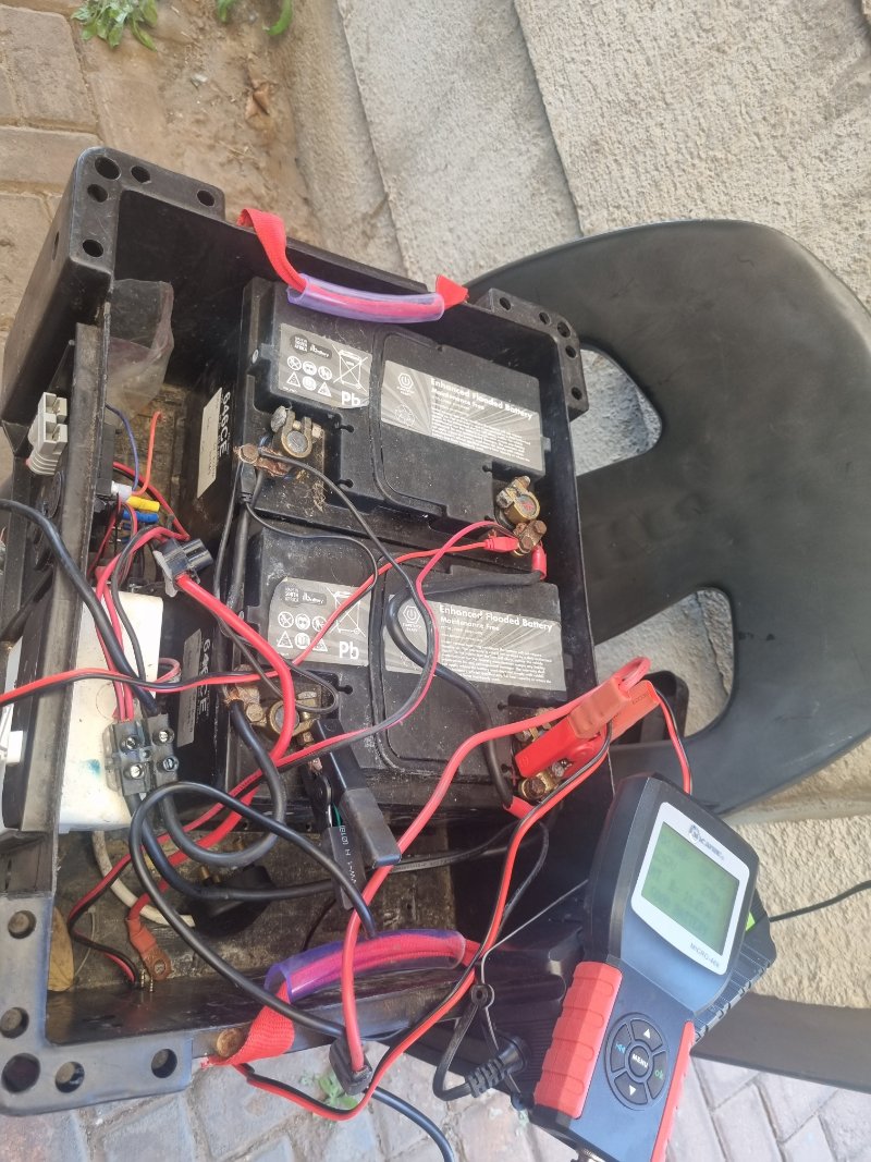

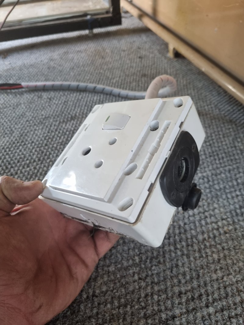

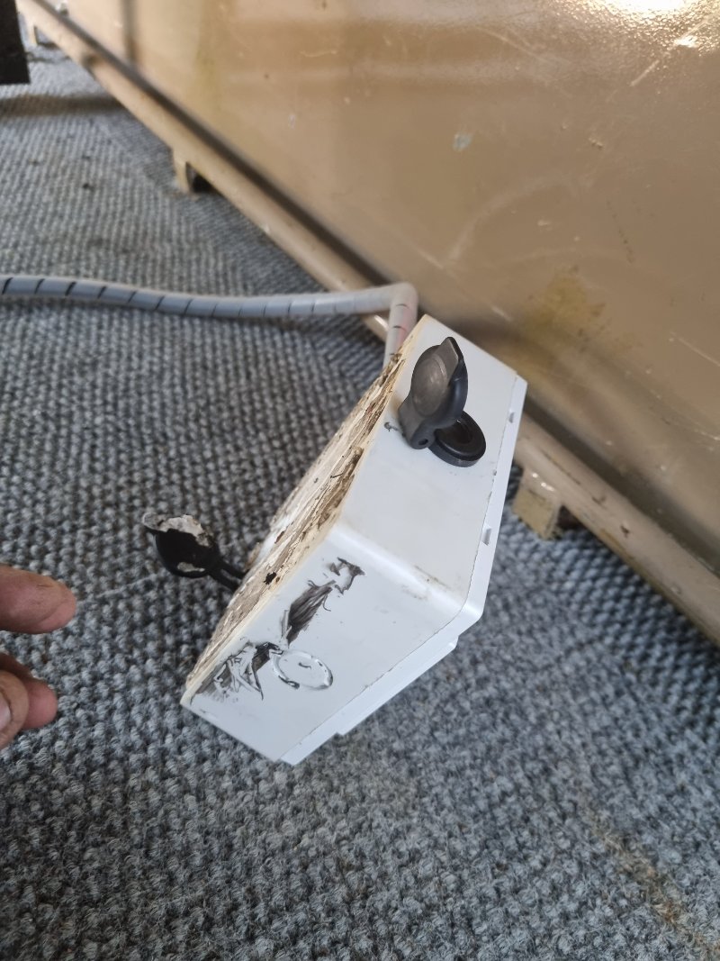

My recently acquired trailer is a prime example
12V DC and 220V AC crammed in to a AC 4x4 plug box
And the 2x Deep cycle battery box with the thick wires as extra laying loose in the box with eye lugs on the ends not even closed with insulation tape
Guy thought it should not short as it is in a Plastic ammo box
I removed everything and will be doing a proper installation
