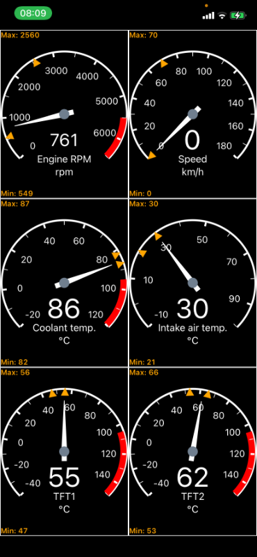

Now seeing as it is a ‘sealed’ unit, which is bull. I read up on replacing my Oil. The manual stated that Oil must be drained off and checked at 42Degrees if memory serves. That done and dusted with new oil/strainer and gasket. I soon realized that if the vehicle indeed measures the oil using its OBD2 port, I should be able to measure Oil temps myself. Two sensors, one in the pan, one after the torque converter.
Purchased myself a VieCar4.0 Bluetooth scanning tool (R400), after the BlueDriver(R1200) could not input PID inputs. Now this is specifically for the A750f inputs, many others are available on the internet. I downloaded Paid software (iOS) named ‘Car scanner’ – Android (Torque Pro) and used the following parameters:
For the transmission pan temp:
Pid: 21d9
Min: 0
Max:100
Symbol: °C
Equation: (((((E*256)+F) * (7/100) – 400)/10)-32)÷1.8
For the transmission converter temp:
Pid: 21d9
Min: 0
Max:100
Symbol: °C
Equation: (((((G*256)+H) * (7/100) – 400)/10)-32)÷1.8
Bringing me to a point where I can now measure my own Transmission temps using my phone. After playing with the App, you can set various parameters and upper and lower limits to warn you in time.
So with all this info in hand I soon realize that my Transmission Oils Runs at higher temps than what I am comfortable with. More reading on the internet I realize that WS(World standard) Transmission Oil sits comfortably at 85 Degrees, Preferably at 65 Degrees, not trying to exceed 95 Degrees for long periods of time… Toyota being idiots in this regard, only have the A/T warning light come on at 149 Degrees, whereby your clutch plates are definitely already glazed up, Oil burnt, an possible damage done. Those interested in oil temps and degrading - there is a lot of info on the internet...

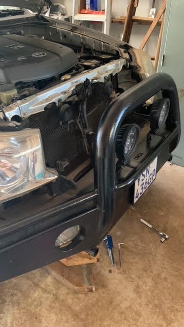

So next Rivertrip,2021, (now with ONCA bumper fitted) I start to look for temperature issues. Only to realize that temperatures seem fine in the beginning, but about 2 hours into the drive and sun coming up, temperatures quickly escalate into figure above 100-110Degrees constantly. Cooling down on the rocky sections to 90 Degrees and going up to 115 Degrees in sand. Even saw 120Degrees sometimes. And yes I did make a point of it to lock up the torque converter where possible. Not only does the A/T oil temps rise, but the water temps also start rising to close to 100Degrees, where they should be sitting at 88Degrees ranging to 92 Degrees when working hard.

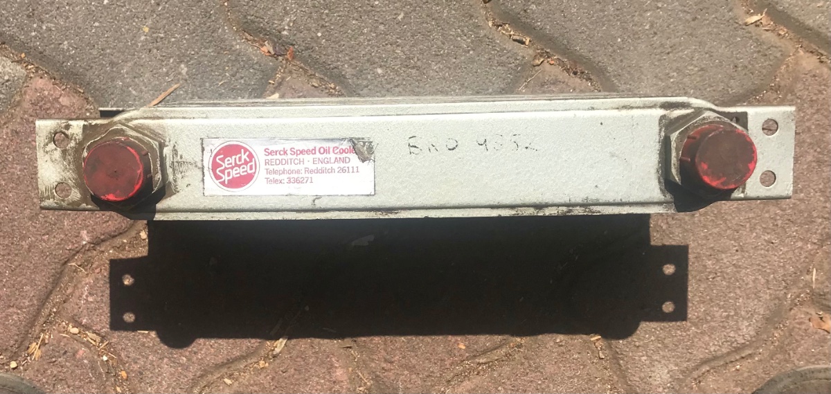

Now addressing the issue, I know the Prado’s and Mitsubishi Have external coolers fitted to them. So I decided to give these a go. I ordered myself a Hayden 679 Oil cooler from ‘All-O-Matic Transmission’ in Jo'burg – Great service, next day delivery with card facilities – wow!

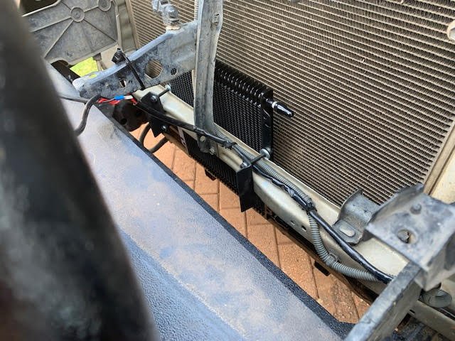

3. Use both system(My Chioce) where the oils runs from the gearbox to the original Shell and Tube, then in series runs to the external Oil cooler, then back to the gearbox.
In many parts of the world this system is known as a towing upgrade, actually offered by dealers – but why do this in SA??? The faster something breaks the faster you can bullshit them into buying a replacement one, and blaming them for not looking after their vehicles…

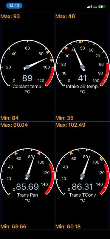

Installed and ready before Rivertrip 2022 – Now also with larger tires. Conclusions are found that this has OVERALL decreased my temperatures with about 25 Degrees, putting me right back into the sweet spot I want to be! A/T oil temps never exceeding 100 Degrees (even in overdrive). And finally coming to a point where my A/T oil stay constant and my Water temps rise –DUE to engine working itself to death and not the oil rising the water temps! As soon as I back down the water jumps back to a beautiful 90Degrees almost instantly! All and all a win in my books and can now go back to playing as hard as the motor will allow me without having to worry about A/T oil temps…

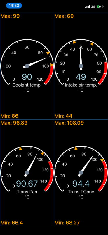

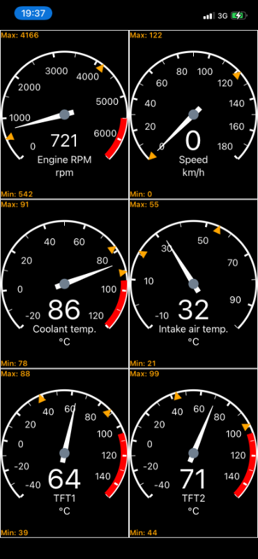

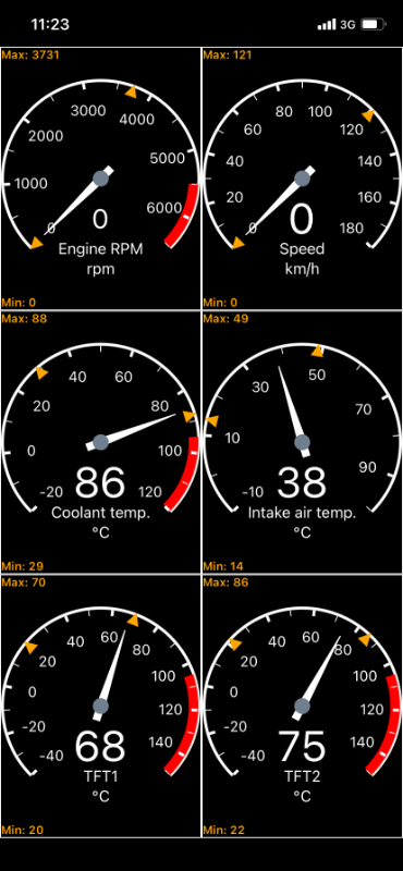

Before Oil Cooler installed - Highway Driving
Before Oil Cooler Installed - Rivertrip
649 Oil Cooler purchased
Post Cooler install City Driving
Post Cooler install Highway Driving
Post Cooler install Caravan Towing - Lot of overdrive and mountain regions!
Post Cooler install - Rivertrip 2022
Bumper strip - Looking for suitable position is tricky - Not ideal for wind flow - But cooler was over specified, so not worried.
Oil Cooler Placement

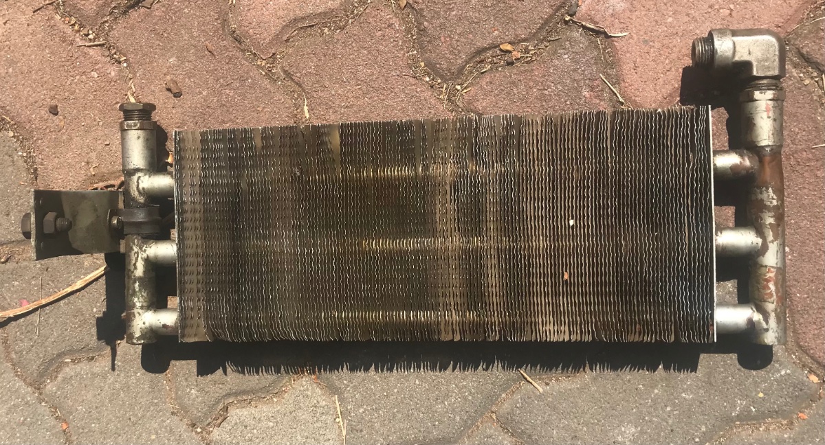

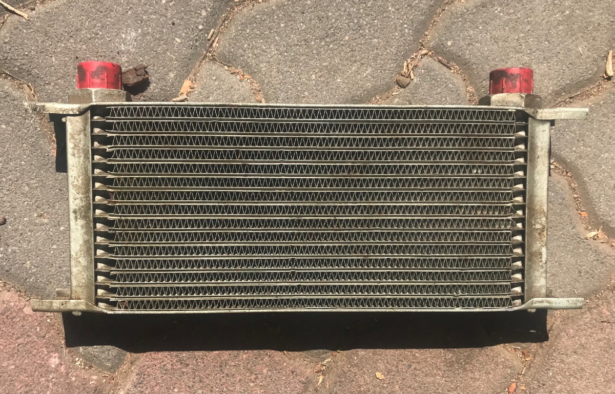

… I have concidently also just bought
some heat exchangers - for oil and air -
which I will use on my RR Classic & S3 88” …
Top to bottom
Top view of smaller Oil Cooler

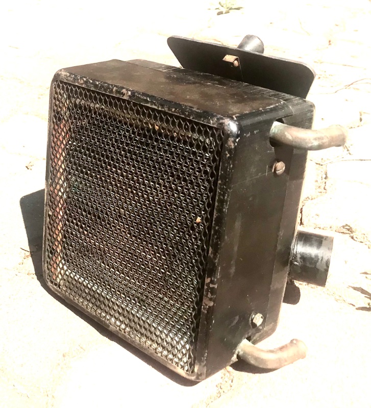

Cabin Heater for LR Series
Then
Oil Coolers
Should have called the Thread:
"Oil, Boil, Toil and Transmission'...
