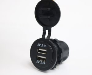

If you want to charge phones, rather than the cigarette socket, fit one of the dual USB outlet fittings. They work a lot better than a cigarette socket with an adapter in it.

Good call on the USB and volt meter. I'll add that.

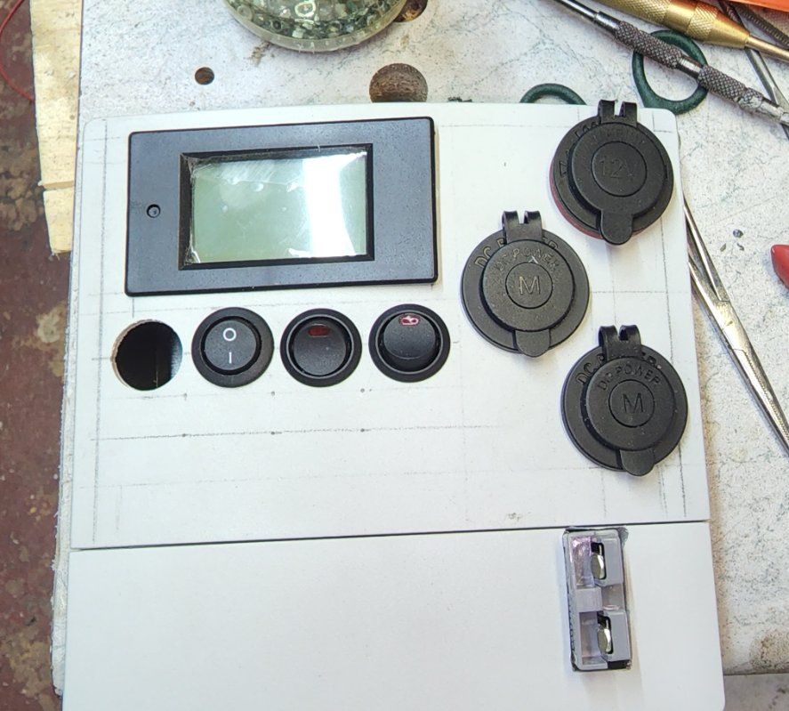

Started with the control box in the back but ran out of switches. I bought the rest today and will show my proress over the weekend
