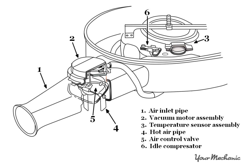

The exhaust manifold ducting system used many moons ago usually had a crude automatic heat activated flap to close the warm airflow to the carb and open the cold air intake. This usually did not work though.Wooky wrote: ↑Mon May 28, 2018 12:25 pmThanks Chris,
That is one of the alternatives I am looking at and is possibly the better way of doing it as it actually warms the incoming air.
I was just looking to see if anyone had come up with a sneaky electronic way to heat the carb so that I could switch it from the cab.
What I am actually trying to get to is that it should be possible to connect a cable to the flap and open and close it as required from the cab.
Some of the older Corollas had a vacuum operated mechanism which you may also be able to convert Some older cars also had a spring loaded selector on the air cleaner nozzle for manual selection, which should be easy to convert to cable operation.

The air cleaner box has a change over flap but only manually operated... so works very well but does require a stop and tinker under the bonnet to make the change.
Hence the interest with going electrical.
