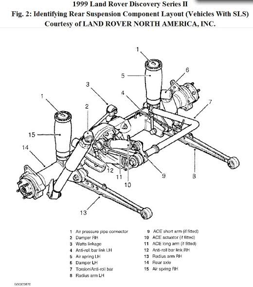

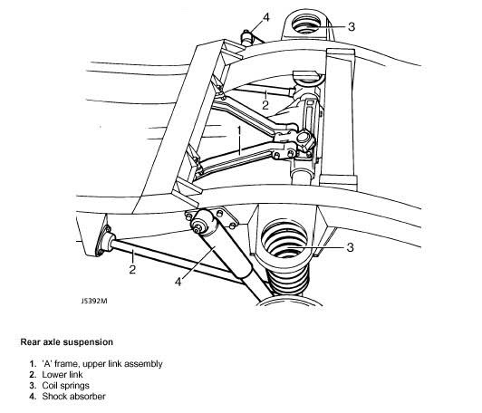

The suspension and 'fulcruming' limits of not only
the front but also the rear axle is crucial to maintaining traction and its evident in the different Landies.
My RR Classic can have the front left wheel jacked up
76cm from level ground and , at the same time the rear right wheel also jackedup 76cm before the other diagonal wheels start losing traction... and it only has 15inch tyres
and is much lower clearance than my 130 Defender.
Both have wish-bone style A-frames at the back with a
ball joint fulcrum. The self-levelling unit on the classic doesnt have any effect on the flex.
My 88 Series 3 on the other hand seems to just anchor and locate the back axle via the leaf springs and inclined shocks and it has two straps (!) to limit excessive drop of the axle ! ( and no radial arms)
The Disco 2 on the other hand has, I think, yet another
set-up that must be influential iro axle flex and travel.
The ' Land Rover 110' was a boxy Defender style follow-on to the RRC but shared the same chassis suspension set-up as did the Disco 1 so its surprising they opted to change the D2s rear configuration.
Disco 2 set-up ...
Disco 2 set-up ...
Defender A-frame set-up ...
The Range Rover Classic, the (real) Defenders , the Disco 1 were all the same chassis and running gear (with varying engines and diffs over the years) . The D90 was 90", RRC and Disco1 were 100" , and obviously the 110", 130" and 150"
The Land Rover series were classic leaf sprung vehciles with the leaves acting as spring, roll bar, longitudinal and transverse location 🤣
and the D2 was improved with a rear Watts Linkage instead of the A frame rear set up, which dropped the geometric roll centre (the A frame roll centre is at the ball joint, above the diff, the Watts in the Watts linkage centre on the wheel centre line) which gave a lot more space for the body, and improved handling considerably!
