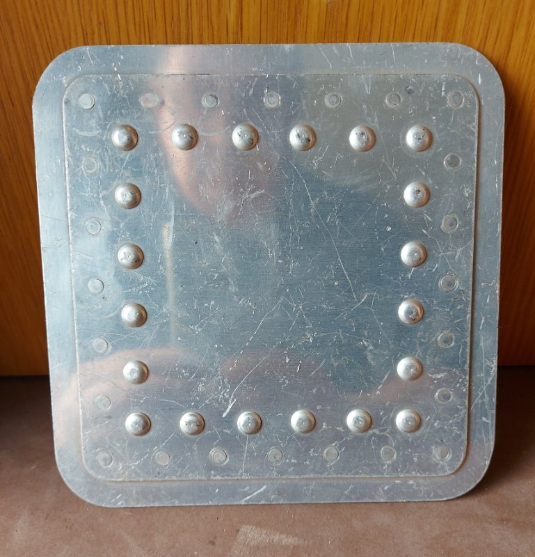

The plate in the photos above was one of the tests piece I had to do for my trade upgrade evaluation. All those rivets are done by hand without a rivet gun. You have to learn how to deform the rivet tail with a bucking iron and hammer before you can have a go with a pneumatic rivet gun. If you don't have the practice you will cause lot's of damage to the aluminum skin with dents you will never get out. Rather than battle with solid rivets use good quality pop-rivets.
