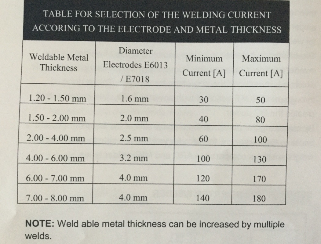

... I’m going to start practicing on some scrap steel , 4mm angle iron etc and with 2.5mm rods.
Will also ensure sun-light on the steel so can see clearly before arcing.
... this is their setting table :

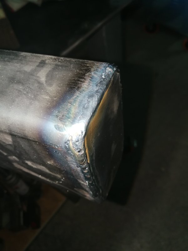

My welding is starting to get a bit better...
Some TIG welding done this last week.
Some MIG welding done the last week.

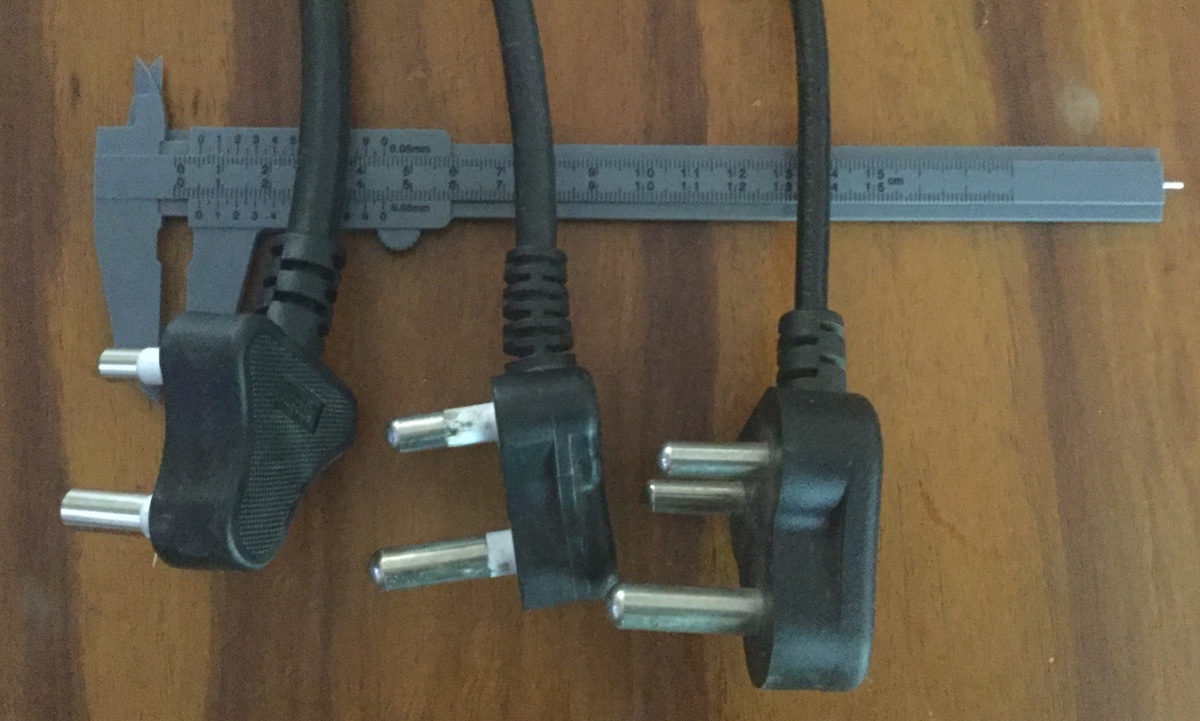

... another thing is with respect to my extension cord :
... the feed cord on the welder is 10mm dia. LHS
vs my ‘heavy duty’ (?) extension of 7.5mm. middle
Vs a ‘normal’ house cord of about 5mm dia. RHS
... not sure what the amp ratings of these cords are ... ?
... peeking under the unit there isn’t a clear indication of amperage
draw from the mains , no doubt depending on the setting etc
Question is could the middle ( extension ) cord melt on draw for low to medium weld settings ?

Make up a dedicated welding extension cable with a good quality plug not one of those molded jobbies. Put a outside type plug box on the other end so it can handle the high amp draw for the welder. Use the heaviest gauge cable you can get for the same reason. When being used unroll the whole cable or its liable to melt....

100mm dia cord?
That's 10cm thick.
You sure?
That's 10cm thick.
You sure?
- Has thanked: 298 times
- Been thanked: 151 times
- Posts: 2008
Yikes ... !
You’re right ... Fixed.
Now, can I use my middle diam. extension cord for 3.5mm rod welding up to say 100amp applied ?
- Has thanked: 804 times
- Been thanked: 1347 times
- Posts: 7281
Yes...
