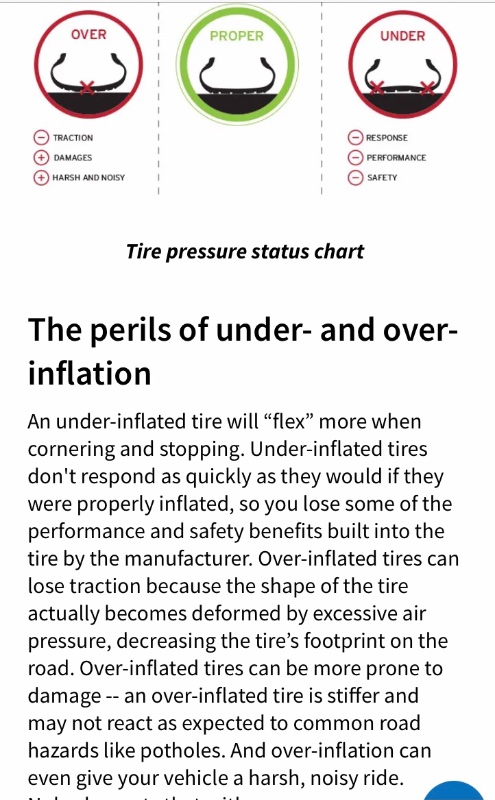

Hey Shane, at school they taught us to read this type of graph:
This solves the “in between” dilemma you have.
