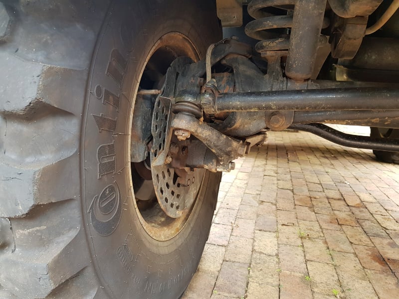

For those interested, a quick snapshot of the Unimog's portal axle:
1984 Unimog 416.163 Doka
Posts: 7184
Not as much of an offset as I'd thought...

Post by dawidloubser »
Fri Apr 13, 2018 10:34 pm
That's why I posted a pic to show you.
It's less than 20cm.
I also gain another 5-10cm with the smaller diff bulge.
Nobody should pay a couple of hundred K for 25cm extra clearance :D

dawidloubser wrote:For those interested, a quick snapshot of the Unimog's portal axle:
Awesomeness

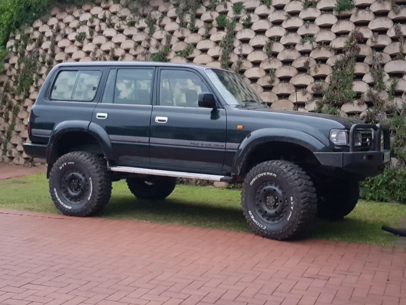

I suspect with the coils springs so close together, that Broozer will have body roll like a Citroen 2CV :shock: :o
