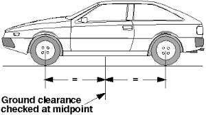

Ground clearance is generally measured between the wheels.
To use Manny’s idea, you make a box 3m wide, you climb onto it , drop the front wheels over , then the ground clearance is the height you can clear until the rear wheels climb over the box.

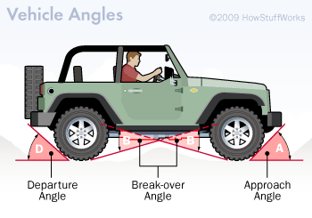

well, break over angle is an angle as opposed to a height which is generally taken as an angle to the centre point of the wheel base taken from the tangent of the tyres:
so a SWB vehicle will always have a good breakover angle even if the ground clearance is low
Ground clearance is an actual height taken at the mid point of the wheel base, so it's unaffected by the length of the wheel base:

breaker angle and , shall we call it 'passover height' are very different and the breakover angle is a bit misleading.
the clearance under the diff is a bit of a moot point - if there is a big rock in the way, you climb it, not try to straddle it.
but once you've got the wheel on top of it, and then come off it, it has to pass under the rest of the chassis.
So , lets say it's a square box 400mm high x 200mm long and 3m wide, and you have to approach it square on....
your wheel base advantage (breakover) is gone, you literally have to have 400mm of clearance on the full length of the space between the wheels to get over it.
by the same token - if the clearance is measured in the middle of the wheelbase, it doesn't mean there isn't rigging and so on in the way towards the wheels. Trailing/leading arms, wishbones, rods, propshafts, mudflaps are all in the way and lower than the measured clearance.
