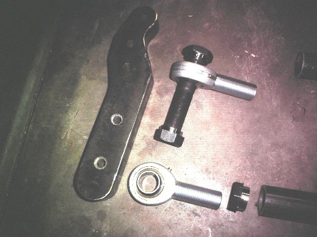

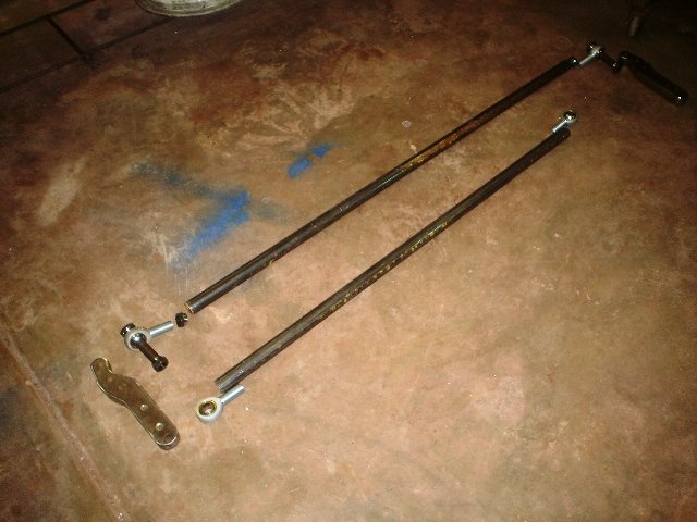

Same samplesImage

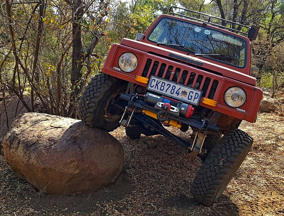

I am running Rod Ends on the Yank Ranger for almost 30k km. Most of that off road and on very bad corrugated roads.
Also use them on my traction bars. Still as good as new.
I do agree with Appoc you need to buy big high quality ones

It will handle those angles easy with a bush like the photos i shared yezterday
Sent from my GT-I9190 using Tapatalk
Wooky
Location: JHB
Posts: 335
Post by Wooky »
Jaco Jeep wrote:
Wed Sep 12, 2018 7:44 am
Cool... thanks
