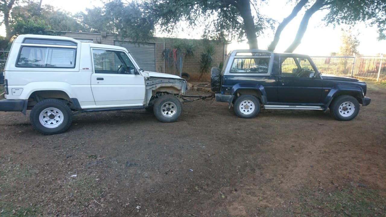

I have a Daihatsu Rocky, and found another on Gumtree without a turbo and injectors. Initially I thought to keep it for spares for the other. (was told the turbo was giving issues and was removed for repairs and lost by workshop)
I a-framed it from Pta to Mossel Bay.
(I have the fender, it was removed to repair ding....)

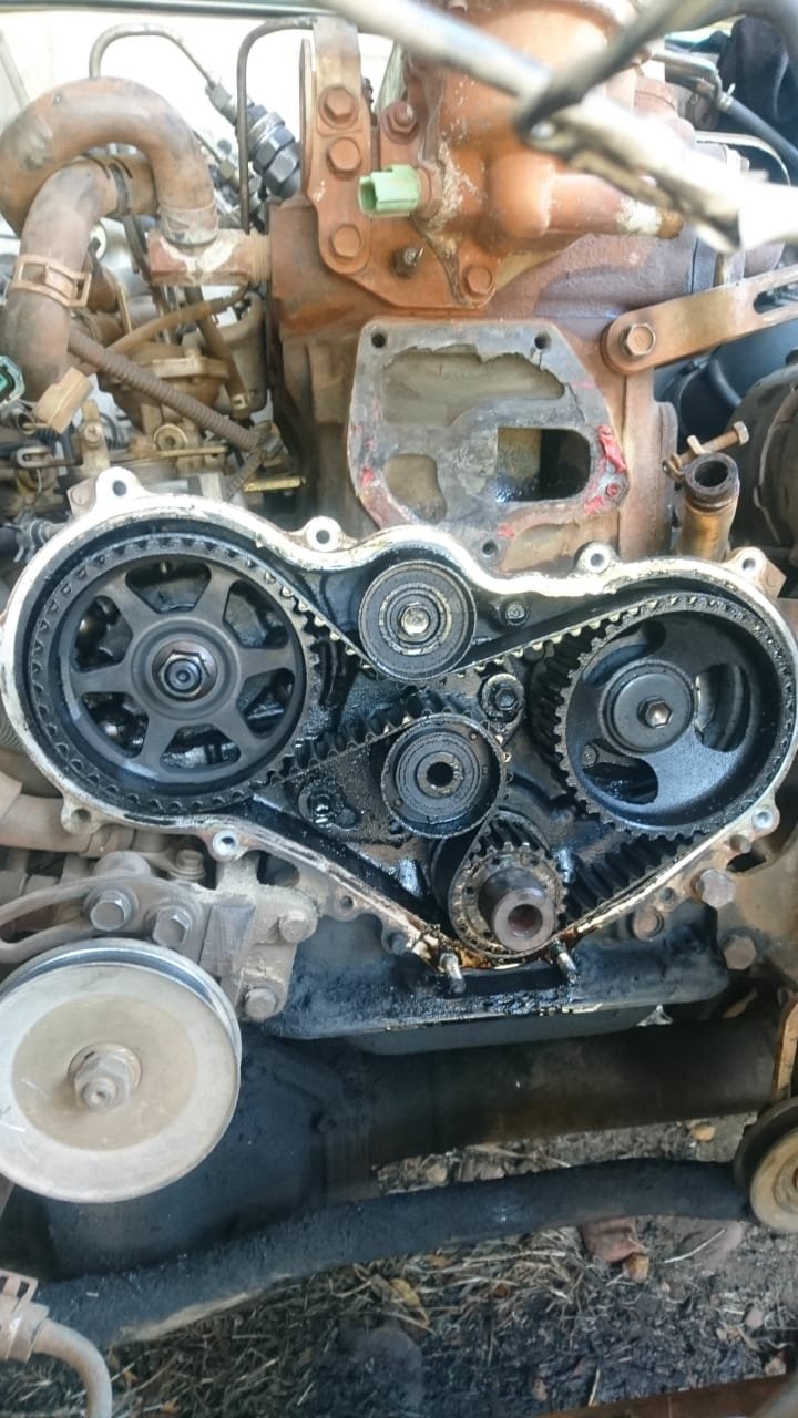

Removed the timing belt cover& found this. All covered in thick black oil.

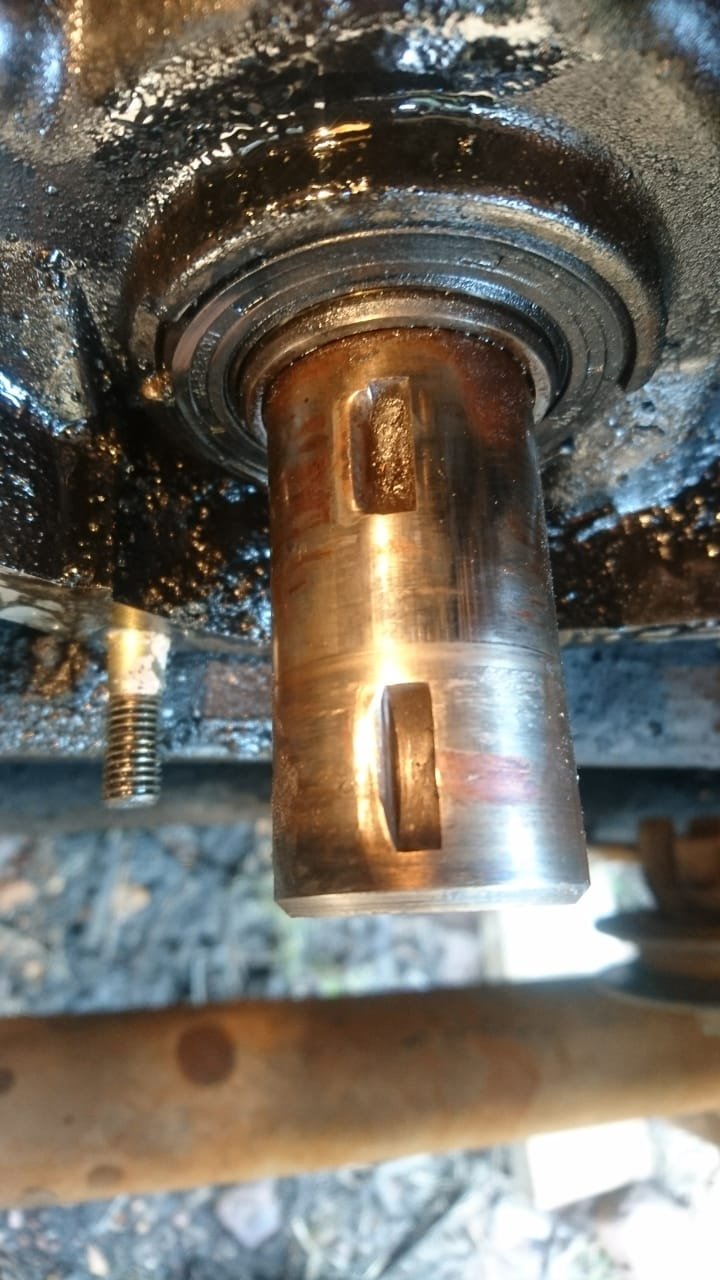

Further I found the bottom sprocket had 15mm play in either direction Image
Removed timing belt and bottom sprocket...again the key in crank was as thin as paper, thus served no purpose. Nice big wear in crankshaft. Image
And thus I am presented with a dilemma and only one choice...remove the crank to have slots machined at 180°offset and sprocket as well. (Rocky spares are not plentiful)
Now I understand the 'misfire', the bottom sprocket was all over the place.
