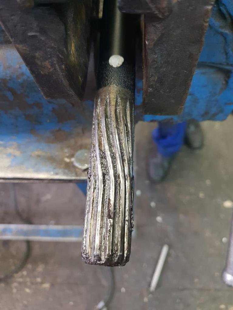

My rear propshaft after some playing.....
Guess some upgrades are necessary :lol:
Do you still have the original 1000cc motor in?
Wooky
Location: JHB
Posts: 335
Post by Wooky »
No... that's the reason it looks like that :lol:
She is running an Nissan A15 with 4.25:1 low range gears in the T-case and 31"tyres.
Still the stock "skinny" prop so not to surprised it looks like it does.
Having a new prop made up with upgraded u-joints and slip joint.
Annoying thing is I had just had the propshaft rebuilt two months ago.
Yeah...
No one would have predicted that to happen

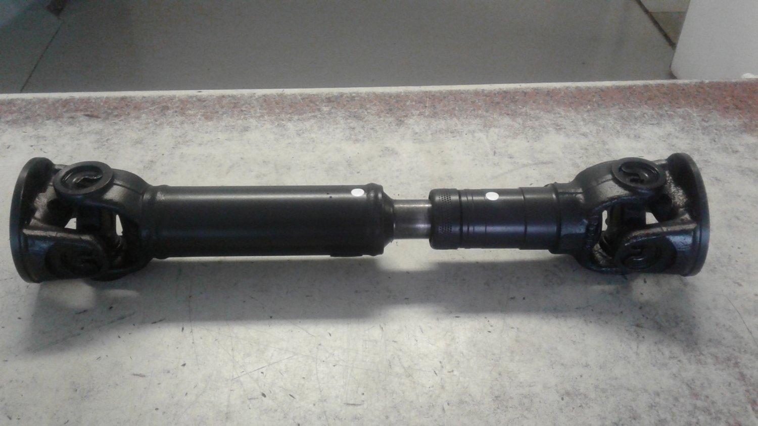

This looks a tad more beefy...... 8-)
Got the new prop made up with 2mm larger diameter UJs and 50mm tube.
Looks good
Hope it will last 😂😂

Hope so too.... but only time will tell :twisted:

The side shafts are the weakest link in the SJ but in this case the prop went.
The suspension is pretty flexy the way I have it now so the slip joint moves quite a lot.
I think this happened on a fairly big rock step when I gave it some juice while the rear suspension was extended leaving only about 50% of the splines taking the torque.
Not really surprised it failed
