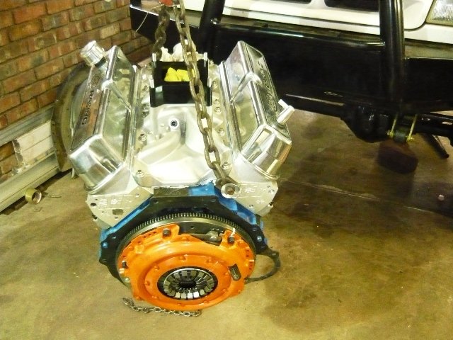

Centerforce the way to go. Have one in the V8 Yank Ranger. Pricey but worth it.

Imported mine via the V8 Shoppe. That clamping force works. If I let the clutch out on idle till the vehicle just start to move. You rev the engine with the clutch partly engaged it jumps forward like an auto box would do.
G60 Patrol v8 and the other v8 Ranger on their second clutch sets. Will go Centerforce on them next time.
