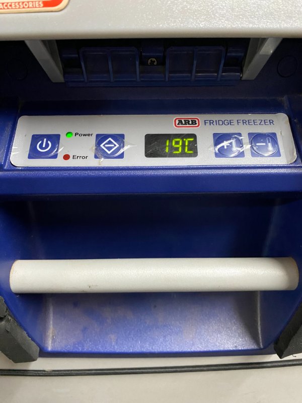

Last day of 2024 when heading out for a new year's party, I saw my fridge registering 60 Degrees Celsius, and was trying to bring it down to its set temperature (0 Degrees). Long story short, everything froze up.

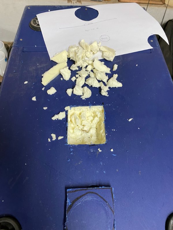

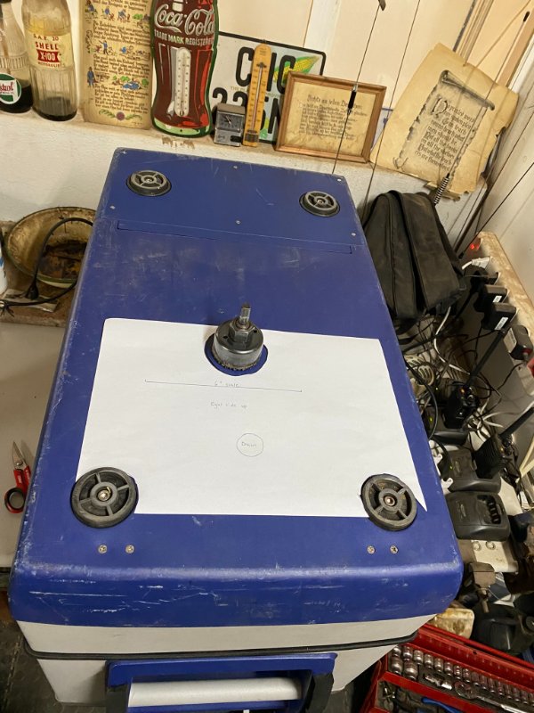

Anyway to get to this enclosed unit, you use a template from ARB:
thermistor fix template.pdf
(62.47 KiB) Downloaded 51 times
Other fridges may vary...

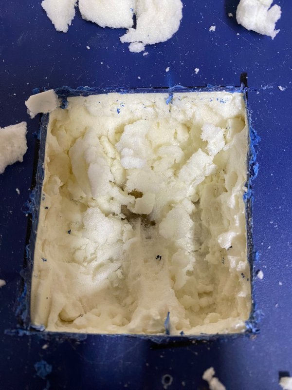

I opted for a dremel instead of a hole-saw.

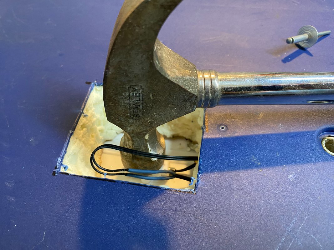

And slowly "chiselled" out until I found the Thermistor:

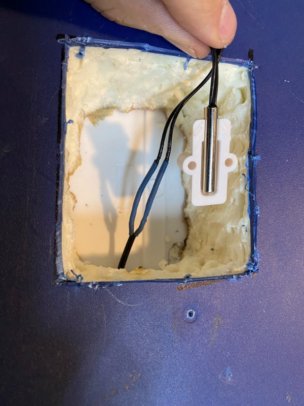

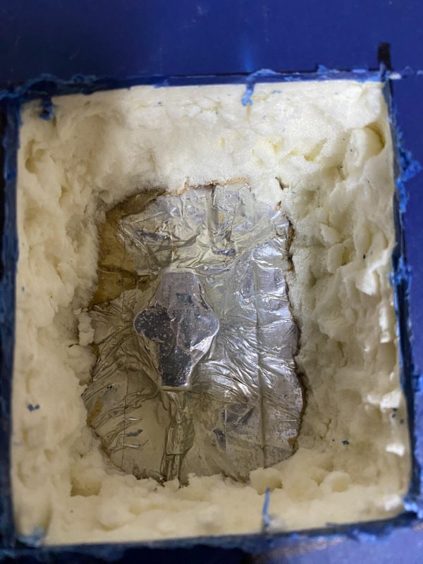

Here I found they used a piece of Foil to reflect some of the heat, very clever:

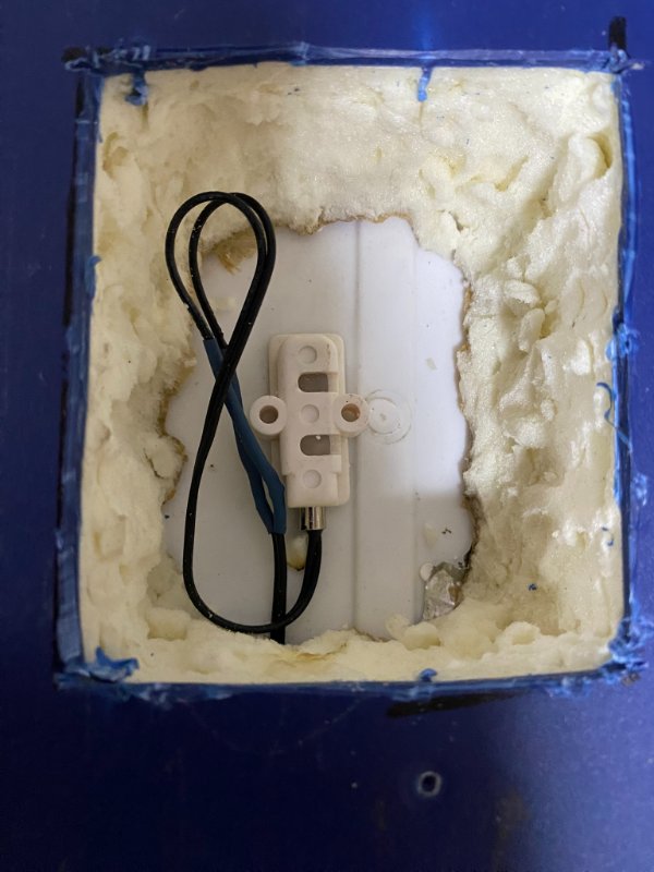

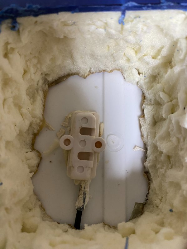

Finally found the Thermistor:
Measured to make sure it was indeed broken, cut the wires (they do not have polarity), used heatshrink, and soldered the purchased one in its place:

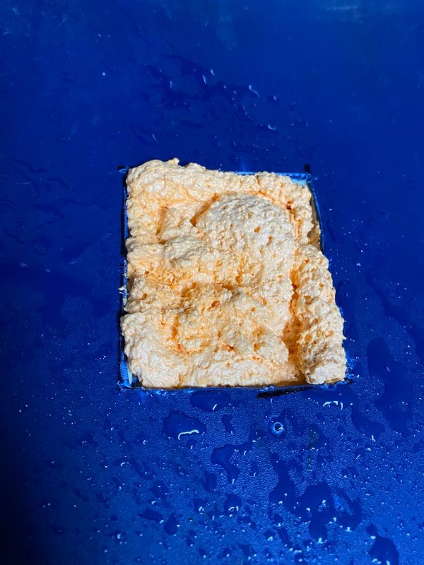

Bought some adhesive foam and covered the hole with the piece I cut out:
Finally made everything neat:

Thanks. I see in one Pic that you hit it with a hammer...

Interestingly i had a similar problem earlier this year with my Snowmaster 35L whereby digital temp reading was variously erratic or steadily reflected a temp of abou 23 C .. I would then generally find fridge was closer to freezing Temp.
I did however have the fridge positioned on my Transmission Tunnel which can be fairly hot at times ...
however running the fridge indoors over Xmas everything was quite normal and cold Beers was order of day.
