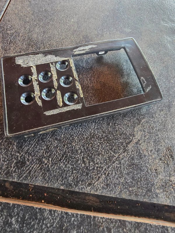

Gathered the USB connection had broken off the circuit board, and the small PV panel attached to it so that one can charge from solar no longer works... And then the case looks absolutely horrible. Warped and broken. The face-plate for the remote was still in good nick though, so I removed it...
The following photograph is the front cover after removing the face plate. You can see it's not lekker...
