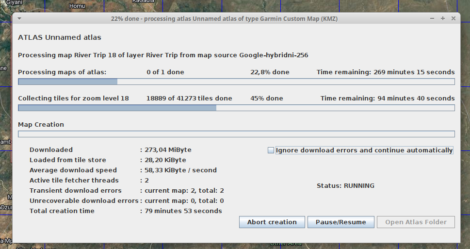

Usage is easy, but settings (especially the zoom level) will need to be customised according to the device you want to use (ie: screen resolution and similar). Simply select the area you're interested in, select the zoom-level, click on "Add Selection" you want and then generate the atlas. One caveat: you cannot have more than 500,000 tiles in a single custom map.
It may take a while for the map to be generated originally as the tiles need to be downloaded from Google. Subsequent runs (where tiles have already been cached locally) are much faster...

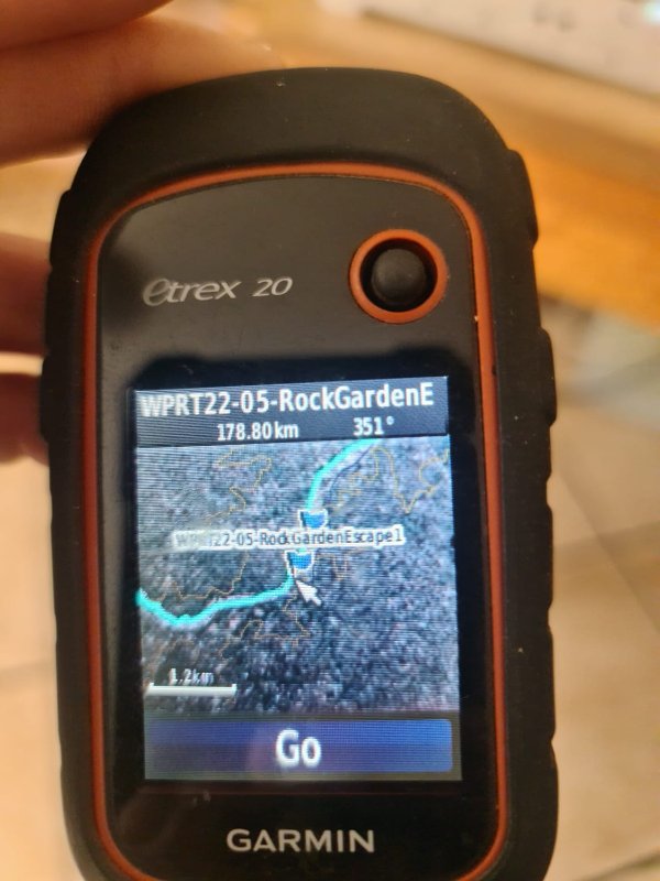

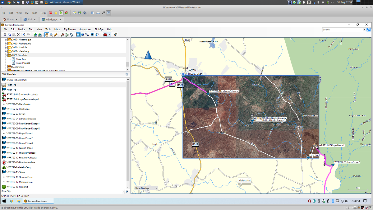

The custom map can be imported into BaseCamp, where you will have your "routable" map (ie: tracks4africa / whatever) with the map displayed in the background. Here's the section of the Klein Letaba in BaseCamp... :)
To install the map on your device, connect to a computer and copy the KML file generated by MOBAC into the Garmin/CustomMaps folder.
