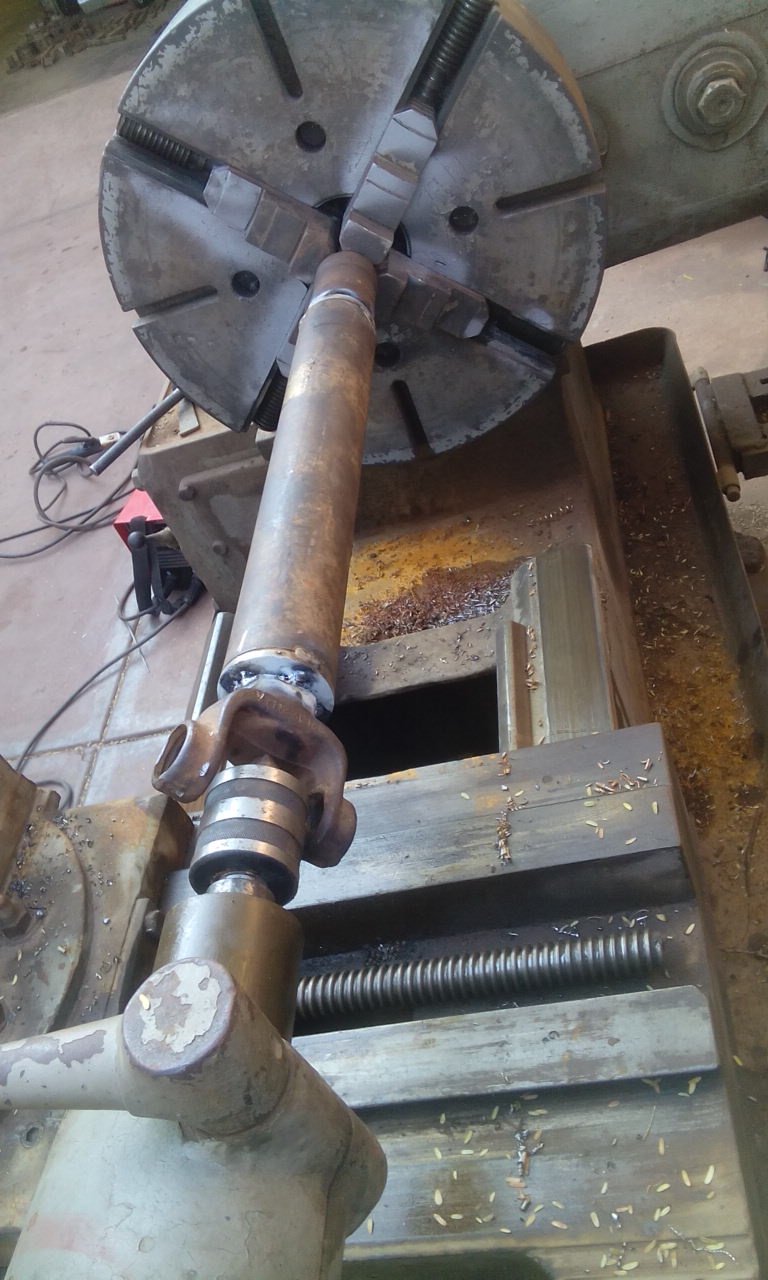

I build my own prop shafts. Use thick wall seamless steam pipe. Prop Shafts and UJ`s can never be the weakest link in a drive train. Snapped prop shafts or UJ`s can kill you. Breaking a prop at speed can knock a vehicle to bits. There were a court case against Ford many moons ago where a UJ failed on a new Escort. It dug into the tar and flipped the car killing the driver.
Side shafts are the weakest link. But then you only snap them with real v8 power..
Back building prop shafts. Align the, 100% with 0.001mm run out in a lathe and you need no balancing. See DVR is a member here. He share my views. He also build his own props.
Attached pic of me doing one for the little V8 Patrol :D Also made my own adapter between Patrol prop and Cruiser H55 box

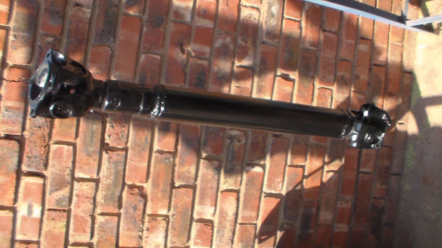

(flat/easy areas only) and then on down to Upington where Mech shop made up new prop with piece of pipe and new universals and all balanced in a lathe type set-up...
just as photoes in prev posting

Hunter I have twisted normal prop shaft tubing with a v8 producing 600nm. To date I failed to twist thick wall seamless steam tubing.
Have had new prop shaft tubing in the lathe with a few mm of runout.
