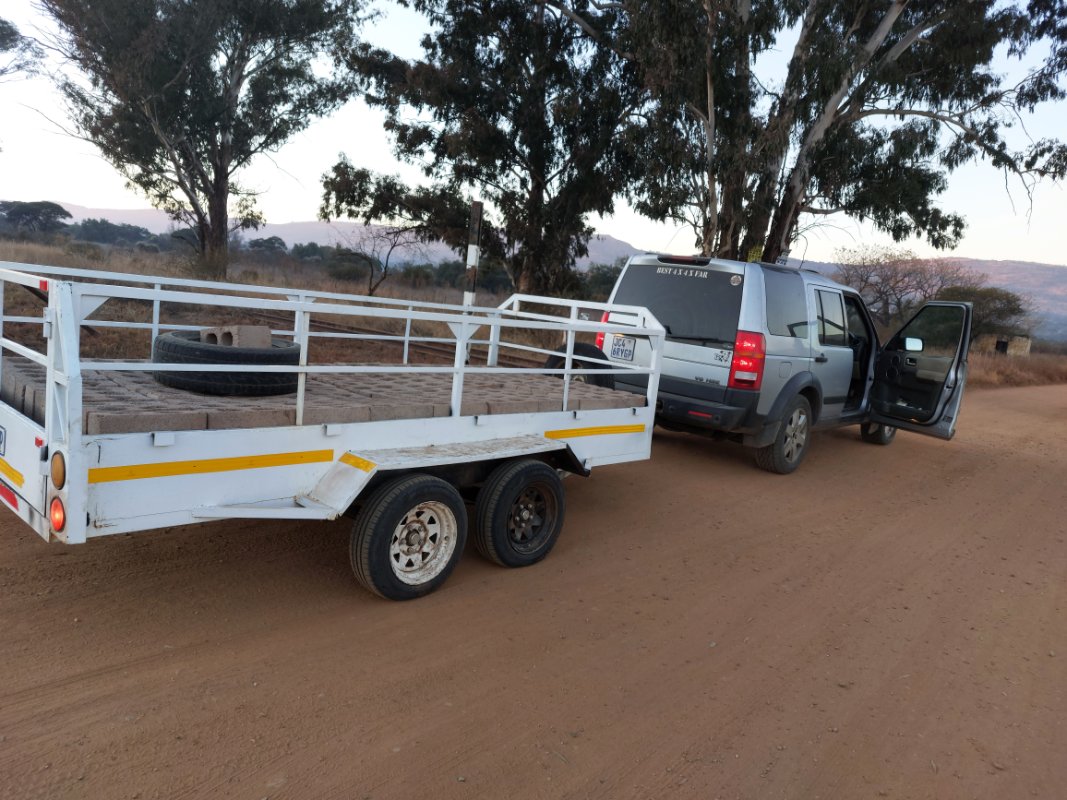

I did a bit of heavy towing last weekend , with the D3 . I found it very capable . Yes , it is a V8. Its not a bakkie , but it really impressed me

Johannes ja dit gaan nie net oor n V8 nie , gaan oor die overall gewig van die voertuig ook.
Has thanked: 376 times
Been thanked: 38 times
Posts: 824
Ja Leon. Die D3 is redelik swaar . Het my net bietie misgis met die gewig van daai blokke :o hulle weeg so 15 tot 16 kg elk . Het nie geweet nie . Tot ek afgelaai het.

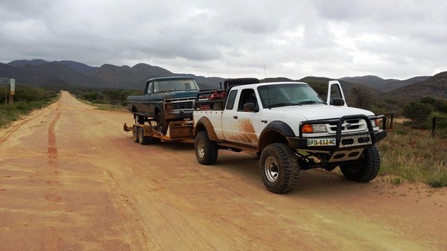

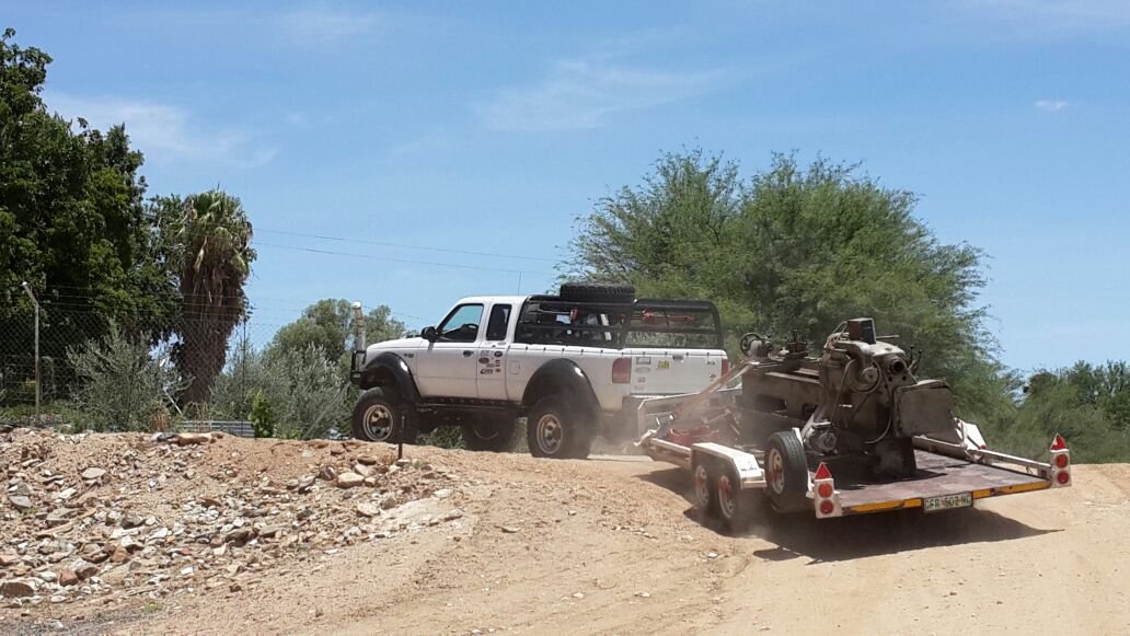

I have towed some heavy loads.
The V8 American Ranger I built a few years ago with its 600nm was the best I have owned.
Once had the privilege to drive a friends imported American F250. That beast had a towing capacity of over 6T. Cannot think of anything that can match an American Full size Pickup.
First pic 3T lathe that I bought from a friend in Upington.

Mooi bakkie daai Christo !
Oom Christo, daai V8 idle seker "gallon, gallon, gallon"
:D
