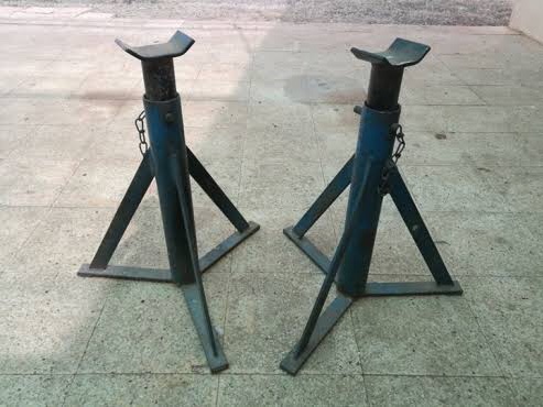

I often use Normal Extendable stands and or Tree- trunk Blocks ...

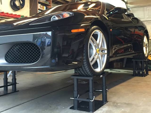

The third picture below shows adjustable 4-legged stands for each wheel ; with a Hi-Lift
jack one could get car up to a fair elevation ...

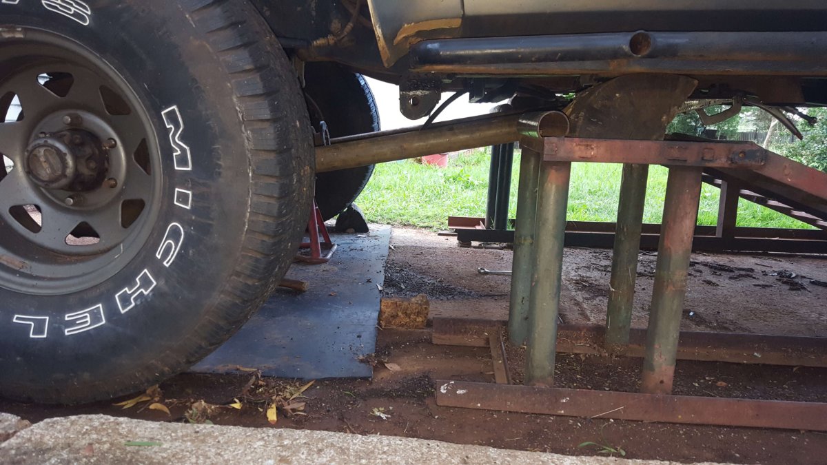

I know the first picture, It comes straight out of the old Fortuner service manual. Apparently those Fortuners could tilt to those gradients quite easily.
I like the idea in the third picture, but would modify the stands to fit a scissor or bottle jack within the stand - giving you the freedumb to jack up each wheel individually.

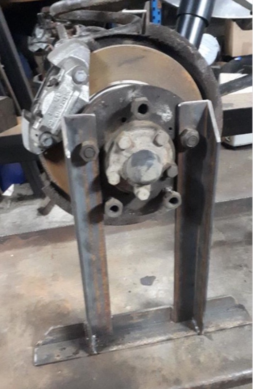

The last picture is just reckless. It will not stop a vehicle IMO from swaying side to side - perhaps a bigger base plate with 45 degree supports would make it a better proposition.
Yes ... for last picture/idea would do that
... bigger base plate plus side supports
to counter side-sway .
Would also put cross-bar to also bolt
the lower two studs of the hub.

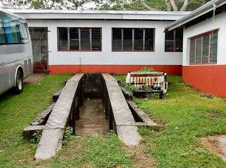

Given one doesnt have a walk-under
vehicle lift or pit ...
then lie-under alternatives only really need the car underside to be about arms length high to use spanners e.g. on what are often v. tight/ frozen bolts...
