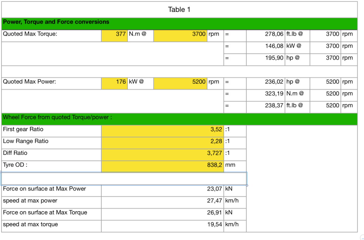

here is a completed example using my JK Rubicon with 35s - obviously, you only change the yellow areas to get the results out...
also bear in mind that an Auto has a torque convertor which is effectively another multiplier until it locks up .

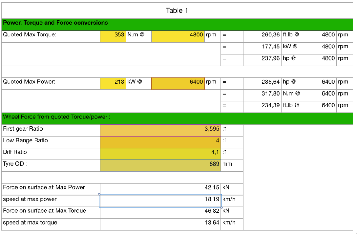

and for comparison, this is an FJ Cruiser sitting on 33s from what I can tell in terms of ratios etc:
Thanks Alex.

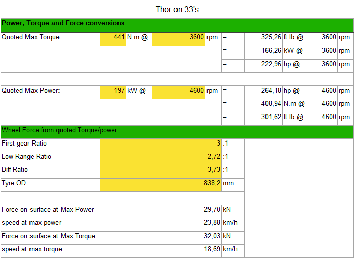

Here are the calculations for THOR - first with stock 30.6 inch tyres and then with 33s
