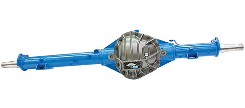

Another solution is to fit a rear diff from a 80 Series Cruiser as Toyota when going wide nose used the 80 Series front diff in the 70 Series.
The 80 series had a 1595mm front track width and 1600mm at the back. Fitting a 80 series rear involves lots of welding and modifying as the 80 Series had coils at the back vs the leafs of the 70 Series.
See that the Aussies have a Dana 60 special design to fit the 70 Series for axle width correction. But I know it is only me I have sort of lost my faith in Dana diffs. Would also rather keep everything Toyota just in case on venture into the darkest of Africa and need to sort out a rear diff problem.

- Dana_60_Rear_Axle.jpg (10.97 KiB) Viewed 10689 times
