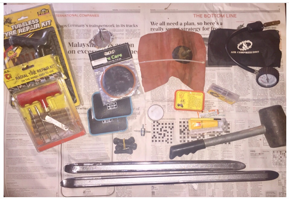

Herewith a photo of (most of) my tyre kit:
TYRE KIT
Compressor
Tyre Pressure Gauge
Tyre Snot Plug Kit pierce/rasp/needle
Tyre Spanners / Crate Spanner-Lever
Spare Tube
Large Patches
Mushroom Plug Patch
Cut-out of Valve from Tube
Valve Tools
Tyre Glues/kit .. several tubes, viable.
Rougher/ coarse SandPaper
Wire & Cable Ties to stitch side-gashes
Rubber Mallet/Hammer
Soap ... sunlight etc lubricant
etc
... and , of course, gloves,jack,
wheel-spanner & blocks etc !
(NB not everything on list is in photi.)

A very impt point is to get a steel-handled
piercer for snot-plugs ... ie NOT like mine!
Plastic handles are prone to letting the spiker
come through backwards and thru
the palm of your hand .... !!!
Please add/correct/comment ...
I will update/ correct this list etc
as/if thread develops.

your kit looks pretty complete Chas. I would suggest 2 more tubes of rubber cement. Those tubes have a miracle property which causes them to completely dry out once opened, no matter how well they are sealed. I carry a small tin of rubber cement. It fits nicely into the empty space in my duct tape roll.

Good lessons, thanks Chas.

Tyre valve stem puller makes life much easier when replacing the valve stem.
Not easy just pulling with the normal valve tool
